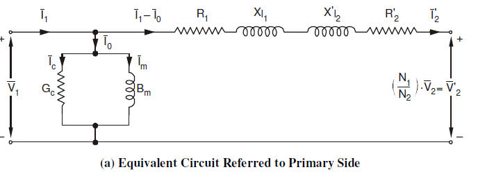

If i have a transformer, and i need to calculate the core losses using this approximate equivalent circuit, according to the lectures ( taking an introduction to electrical machines course in college) the Pc ( power lost in core) = (V1)^2/Gc, but the professor clearly stated that the core losses are always the same, independent of the load, but V1= V2'+I2'*(R1+R'2+(X1+X'2)J) and I2' depends on the load, how come ? when i thought about it i was like maybe he meant V1 at full load, but there is no way to make sure if i am correct and i can't seem to find any answers on the internet
When you have a load, both V2 and I2 depend on the load, V1 is independent of load and those core losses depend on V1.

yea but how come V1 doesn't depend on the load and it depends on I'2 ?
You are assuming that V2 is given and constant. It isn't.
that's the problem, as far as the course goes ( because it's very basic) if we have for example a 2400/240 transformer, V2 is always 240
No, V2 is 240 only with no load, when I2=0.
Put a load resistor R across V2, then solve for both I2 and V2. With a short circuit, R=0 and V2=0.

Your circuit says "Referred to primary side" . That's where V1 is connected.
This drawing i guess is from your textbook?
proxy.php?image=http%3A%2F%2Fblog.oureducation.in%2Fwp-content%2Fuploads%2F2013%2F05%2Fgg.png
(orange)Power in the core is V12 / Gc . You know that from basic Ohm's Law and P=VXI Bm is inductance and dissipates no power. Those other R's and X's are in the windings. And X's dissipate no power.
(yellow again) V12 / Gc is core loss, and there's no load term in that
V1= V2'+I2'*(R1+R'2+(X1+X'2)J) that's Ohm's Law, isn't it ?
I2' depends on the load, how come ? Ohm's Law ? Isn't I2' = V2'/Zload ?

I submit that R1 and Xl1 are shown on wrong side of core because magnetizing current flows through primary windings.

so...first about the model, the professor said the current flowing to the Rc and Xm is very small about 2%, so he would neglect it and say that I1 is = I2 and that's why they are series, we usually do a lot of things wrong for the sake of being easy because it's an introductory course after all
secondly about V1 being constant, like you said we're doing things backwards, we're calculating the V1 that will give us constant V2, which means that if a 2300/230 transformer is given we set V2 as 230 and start calculating V1
about the I2' , we usually calculate it by X*Srated/V2' where X is the load ratio because about 80% of the questions he never mentions a Zl
and i just found this solved example in the textbook and i hope if you can help me understand why he did that
he had this transformer then he did the OC and SC tests to figure out the Req Xeq Rc and Xm
then we drew the circuit, just like the one above, this was a 2300/230 transformer, he said he will refer it to secondary, then he said that V2= 230 and then he said he wanted to get V1' at full load and Pf of 1 and 0.8 , to get them he first got I2 by dividing Srated by 230 (V2) then he said that V1'= V2+I2*Zeq , but of course because the Pf is changing the angle of I2 is changing hence V1' is changing so he got for Pf =1 V1'= 232 V and for pf= 0.8 V1'= 234 V
then he asked for the efficiency at pf = 0.8 and full load so what he did was simply 234^2/Rc
and that's why i am asking this question, somethings like the Pf and the load ratio (X) can and will change V1 which will then change the core loss which i know is constant, but the textbook author just uses whichever V1' suitable for the conditions given in the question which is the V1' at Pf=0.8 and X=1
but i think you do have a point, maybe this whole misunderstanding comes from the fact that we do things backwards, consider V2 constant and calculate V1, not the other way around. ( i tried to ask the professor, sent him emails but he wouldn't answer, and the final is on Thursday so i am kinda stuck)

Aha ! He decided to work it backward. I wonder why ?
I would not have done that to undergrads.
Aha !
I'll wager he worked the problem same way he tested the transformer,,,
because he didn't have a 2300 volt source at the bench but did have a 230 one ?
And he had a meter that'd safely measure high side voltage when he energized it from low side secondary ?
Of course I'm guessing. But when faced with one of these conundrums i always ask myself "What would make a rational man do that?" . And don't judge him until I've walked in his shoes.
Were I in his shoes with no 2300 volt source, i'd have worked it out backwards too. But i'd have told the students "I'm working this backwards because that's how we tested it ..., and then we're going work it again but forward. "

Referred to secondary is a hint he started at output side.
note z's get multiplied by square of turns ratio ,
so be careful when figuring your Zeq,,,
If R' and X' are referred to secondary, secondary ones are as measured but primary ones are X1/100 ...
with 234 volts at V1, core loss is more than with 230 volts at V1 ,
it's really that simple. But it conflicts with statement "core loss is constant" .
Define your model and be rigorous in applying laws of Ohm and Kirchoff.

IF you're forcing output side voltage V2 to be constant , the math tells you V1 must change with load..
But to achieve that constant V2 you must apply a V1 that you can adjust when load changes ,
you'll see V1 change from 230 volts unloaded (as anorlunda said) to 234 volts as in your worked example
and core loss at V1=230 volts IS NOT THE SAME as at V1=234 volts !
(Did professor plant that prior misconception?)
If professor insists that it is, show him this post. Print a copy for your backpack.
