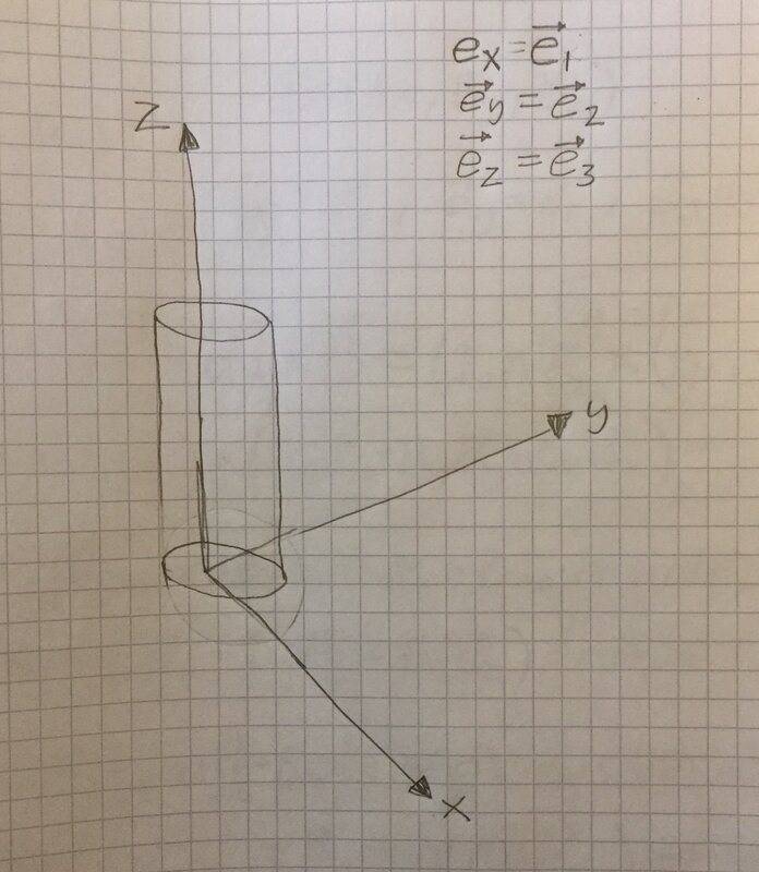

i) I approximate the solenoid as a cylinder with height L and radius R. I am not sure how I am supposed to place the solenoid in the coordinate system but I think it must be like this, right?
The surface occupied by the cylinder can be described by all vectors ##\vec x =(x,y,z)## so that ##x^2+y^2=R^2## , 0 ≤ z ≤ L. One parametrization to this could be ##x(t) = R\cdot cos(t), y(t)=R\cdot sin(t)## , 0 ≤ z ≤ L , 0≤t ≤ ##2\pi## , t = 0 at the x-axis and positive rotation is counterclockvise around the z axis. ##\vec x = (R\cdot cos(t), R\cdot sin(t), z)##
