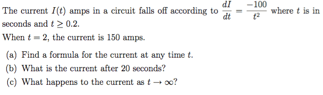

Hi Community,
I have this question:
If I take the information provided \(\displaystyle \frac{dI}{dt}=\frac{-100}{t^2}\)
Setup my Integral \(\displaystyle \int\frac{-100}{t^2}\,dt\)
Take the constant out \(\displaystyle -100\int\frac{-1}{t^2}\,dt\)
Simplify \(\displaystyle \frac{-1}{t^2}= t^{-2}\)
To get \(\displaystyle -100\int{t^{-2}}\,dt\)
Apply the power rule \(\displaystyle -100\frac{t^{-2+1}}{-2+1}\)
Simplify and add the constant \(\displaystyle \frac{100}{t}+c\)
We know that when \(\displaystyle t=2\) the current is \(\displaystyle 150amps\)
So we now can setup an equation \(\displaystyle 150=\frac{100}{2}+c\)
Solving for \(\displaystyle c\) I can refine \(\displaystyle 150=50+c\)
Then take \(\displaystyle 50\) from both sides to get \(\displaystyle c=100\)
Now I know what \(\displaystyle c\) is I can plug it into my equation to get \(\displaystyle I(t)=\frac{100}{t}+c\) becomes \(\displaystyle I(t)=\frac{100}{t}+100\)
\(\displaystyle I(t)=\frac{100}{t}+100\) when I plugin \(\displaystyle t=2\) I get \(\displaystyle I(t)=\frac{100}{2}+100\) \(\displaystyle =\)\(\displaystyle 150\) which is correct as per the initial statement "When \(\displaystyle t=2\), the current is \(\displaystyle 150amps\)."
For the second part when I plugin \(\displaystyle t=20\) I get \(\displaystyle I(t)=\frac{100}{20}+100\) \(\displaystyle =\)\(\displaystyle 105\) So I can see that the current is decreasing as \(\displaystyle t\) increases.
For the third part of what happens to the current as \(\displaystyle t \to \infty\)
Setting this up I get \(\displaystyle \lim_{{t}\to{\infty}}\left(100+\frac{100}{t}\right)\)
Separate into two easier limits \(\displaystyle \lim_{{t}\to{\infty}}100\) \(\displaystyle +\) \(\displaystyle 100\left(\lim_{{t}\to{\infty}}\frac{1}{t}\right)\)
When \(\displaystyle \lim_{{t}\to{\infty}}\frac{1}{t}=0\)
My limit becomes \(\displaystyle \lim_{{t}\to{\infty}}100+100\cdot0=100\)
I would really appreciate it if my working out could be checked to see if I am making any mistakes with clear explanations of incorrect terminology and so forth. I want to be able to learn how to solve any similar questions with confidence.
Many thanks for your time in advance.

Hello, Nemo! :D
I will show you how I would work this problem. We are given an IVP, and so to solve part (a) I would write:
\(\displaystyle \int_{150}^{I(t)}\,du=-100\int_{2}^{t} v^{-2}\,dv\)
I have replace the dummy variables of integration, and used the given boundaries as the limits of integration. Applying the FTOC, we obtain:
\(\displaystyle I(t)-150=100\left[\frac{1}{v}\right]_2^t=100\left(\frac{1}{t}-\frac{1}{2}\right)=\frac{100}{t}-50\)
Hence:
This agrees with your result. :)
Now, for part (b), we may write:
\(\displaystyle I(20)=\frac{100}{20}+100=105\)
This also agrees with your work. :)
And finally for part (c), we may write:
\(\displaystyle I(\infty)=\lim_{t\to\infty}\left(\frac{100}{t}+100\right)=100\)
So, I agree with your results in all 3 parts of the problem. (Yes)
The only issue I really see is in your $\LaTeX$ and exponents. User the caret character, and if an exponent is more than 1 character, then wrap that exponent in curly braces. For example:
t^2 produces $t^2$
t^{x+y} produces $t^{x+y}$

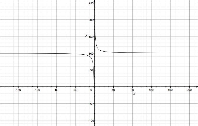

Graphing the function I get the below which appears to correspond with my answer that the current approaches \(\displaystyle 100amps\) as \(\displaystyle t\to\infty\)
Many thanks, Nemo :)
