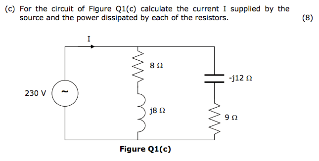

jackrichie said:I've attached the question that I am referring to.
I believe I'm heading in the right direction with this one by stating that:
1/Rt = 1/(6+j8)Ω + 1/(9-j12)Ω
But I am confusing myself with my algebra.
Any help is appreciated
