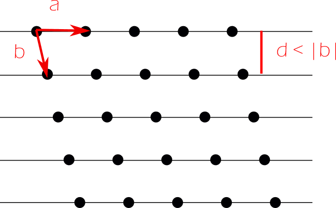

Monoclinc primitive crystal, why is (100) d-spacing not equal to lattice cell dimension a.
Why is it that the d-spacing of the (100) plane is not equal to the lattice cell dimension a.
I can calculate the (010) and (001) d-spacings and they are equal to b & c lattic cell dimensions which is what I expected.

d-spacing formula of orthogonal crystals
[tex]\frac{1}{d_{hkl}^2 }=\frac{h^2}{a^2}+\frac{k^2}{b^2}+\frac{l^2}{c^2}[/tex]
tells (100) d-spacing is a.

I still can't give an explanation in my own words for a reason that the (100) d-spacing is not equal to the lattice parameter for monoclinic whereas the (010) & (001) are equal to their respective lattic parameter.
I compare it to the case of the cubic crystal where it is easy to visualize that the (100) d-spacing is equal to the lattice parameter. However I don't see why this is different for the monoclinic crystal.
Thank you for your input.
The planes defined by the Miller indices are not normal to the crystal axes ##\vec{a}##, ##\vec{b}##, and ##\vec{c}##. Instead, e.g. the plane defined by (100) is parallel to the plane defined by ##\vec{b}## and ##\vec{c}##. This is because the "0" is the inverse of ##\infty##; it means that the plane you're defining never intersects that axis. So the "d" spacing can be less than the vector length.
In the monoclinic lattice, there are two axes with some angle between them and then the third axis is normal to both of those. So only in the case of the third axis will you get that the d spacing is equal to the crystal axis length. In the other two cases, the d spacing will be slightly less. I've illustrated why it's less in a 2D diagram because I couldn't think of a succinct way to write it.
