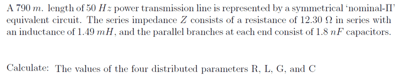

In a course I am studying, I have been asked to calculate the distributed parameters of a line whose Pi model has been provided. I simply quote the question here for clarity of my question:
[tex]C = \frac{{2\pi \varepsilon }}{{\ln \frac{b}{a}}}[/tex]
[tex]R = \frac{1}{{2\pi {\sigma}{\delta _s}}}\left( {\frac{1}{a} + \frac{1}{b}} \right)[/tex]
[tex]L = \frac{\mu }{{2\pi }}\ln \frac{b}{a}[/tex]
[tex]\tan \delta = \frac{G}{{\omega C}}[/tex]
I was hoping to use above equation to solve the problem but then I realized the conductor material i.e. its conductivity, permeability, etc. is missing. Therefore all above equations would be of no use in this case.
Now the question that I can not get my head around it, is what approach will get me from lump Pi model parameters to line distributed parameters? Note that I am looking for guidelines, not the actual solution.
Thanks
