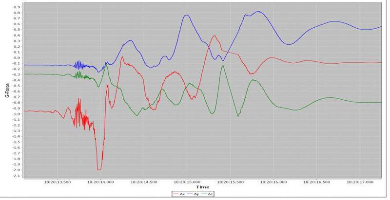

I got this data doing the test using a bottle with accelerometer fitted. The first one is without mass inside just accelerometer. The center of mass is not aligned with the bottle and it shot up very fast(haven't reach constant velocity/terminal I guess).

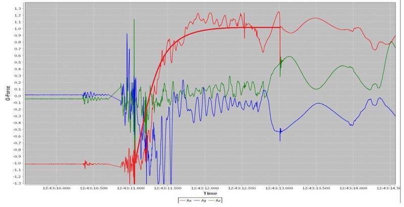

The second test I put nickel and silver penny inside and the object rises constantly by using naked eye but I am not sure whether it is still accelerating. And the good part is the bottle is very straight almost normal to the water surface!

Hello I got the follow result
1) Bottle with accelerometer and off center of mass
2) Bottle with acc with aligned center of mass
I already attach the image in Simon posts, can't duplicate. Thx!

Yeah, I need to reach terminal velocity as quickly as possible. My supervisor mention getting terminal velocity correctly is a challenge. my water tank is about 3m depth.
Thinking about it, you could probably measure the added mass effect in this experiment. (As a native English speaker I think "calculate" means "do a theoretical calculation," but that might not be what you and supervisor meant).
The added mass only depends on the shape of the object, not on its real mass. The same is true for the buoyancy force. The drag force F_D depends on the shape, and also the velocity.
So, if you can do two experiments with different masses m1 and m2, and measure the accelerations at the same velocity, you have
##F_B - F_{W_1} - F_D = (m_1 + m_h)a_1##
##F_B - F_{W_2} - F_D = (m_2 + m_h)a_2##
and you can eliminate the unknown drag force ##F_D## to find ##m_h##.
