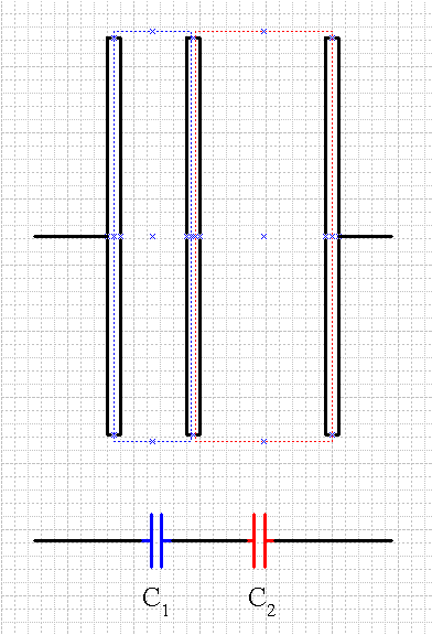

Three conducting plates, each of area A = 3.5 cm2, are connected in such a way that the center plate can be moved between the two fixed outer plates. If the distances between the outer plates and the center plate are d1 = 0.35 mm and d2 = 0.65 mm, find the effective capacitance C of the system.
C = E0*A/d
I have tried adding the Capacitance of each plate (using equation above) with d1 and then d2 and finally d3 (total distance). I added that together but can't seem to get the right answer. I think it confuses me that there are 3 parallel plates because all the examples we talked about in class have been with 2 parallel plates.

The plate in the middle provides one plate for two separate capacitors. Effectively then, you have two capacitors in series.
So I would add the 2 plates on the sides (in series) to the plate in the middle which is in parallel to the outer two plates?

It takes two plates to make a parallel plate capacitor. Each outside plate forms a capacitor with the plate in the center:
So my equation to solve for the effective capacitance of the system should look like this:
C = E0*A/d1 + E0*A/d2
where E0 is (8.85*10^-12)
d1 is the given distance of .35 mm (convert to meters)
d2 is the second given distance of .65 mm (convert to meters)
Am I understanding this correctly?

Not quite. How do capacitors in series "add"?
To add the in series, I would add the reciprocal of the Capacitors 1/Ctotal= 1/C1+1/C2+1/C3... etc
Yup.
I really appreciate your help, I was just not understanding the problem correctly. Thank you for your clarifications.

I am still not getting the right answer. Since the plates are in series, here is what I did:
(1/C=1/E0*A/d1) + (1/C=1/E0*A/d2)
? Where did I go wrong in my calculations

Can you show some details of your calculations? What values are you getting for the individual capacitances? How about the net value?
1/C1 = 1/(8.85*10^-12)*(.035m)^2/(.00035m) = 3.2284*10^10
1/C2 = 1/(8.85*10^-12)*(.035m)^2/(.00065m) = 5.9956*10^10
1/C1+1/C2 = 9.2240*10^9
You need to check your plate area value. The conversion to square meters doesn't have the right order of magnitude.
A = 3.5 cm^2 is .00035m^2 which is 1.225*10^-7 right?

.00035m^2 is correct. But I don't understand where the 1.225*10^-7 comes from or what it's supposed to represent o_O
Well, when I put .00035m^2 (.00035^2) in my calculator, it came out as 1.225*10^-7
Ah. .00035m^2 is already the area in square meters (The units m^2 tell you so). You don't want to square it again!
So then:
1/C1 = 1/(8.85*10^-12)*(.00035m)/(.00035m) = 1.129E11
1/C2 = 1/(8.85*10^-12)*(.00035m)/(.00065m) = 2.0984E11
1/C1+1/C2 = 3.0984E-12
Angie K. said:
So then:
Okay, those numeric values look good.
While the numerical value is correct for the net capacitance, the equation that you wrote is not correct! 1/C1 + 1/C2, given the above values, is 3.23E11 F-1. So you've not shown that you took the reciprocal. When you show mathematical expressions, be sure that what you present is precise.
Also, be sure to include units on numerical results. If you don't, a marker will deduct points or simply declare the answer to be incorrect.
So summarizing, you've arrived at a correct numerical value but need to clean up the presentation and include units on your result.
