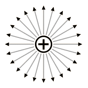

1)
a) Calculate the electric field strength at position (2,3,0) of a 1 coulomb point charge placed at position (0,0,0)
2)
a) Calculate the electrical potential at point (2,3,0)
b) Calculate the electrical potential at point (0,0,0)
c) Calculate the electrical potential difference
e) Calculate the electrical potential difference between (x,y,z) and (x1,y1,z1)
3)
a) A 0.3 Coulomb point charge is placed at (2,3,0). Calculate the force on this charge
4)
a) Calculate the electrical potential energy of this point charge.

1a)
r=SQRT(2^2+3^2) = 3.6
direction of r is pointing perpendicularly away from the point charge.
r unit vector = (2i+3j)/3.6
E=1/(3.6^2) * 8.99*10^9 * (2i+3j)/3.6
E = 6.94*10^8 * (2i+3j)/3.6
E =(3.85*10^8)i + (5.78*10^8)j
2a)
V = E * 3.6
V = (1.39*10^9)i + (2.08*10^9)j
2b)
V = 0
2c)
2e)
will be done exactly the same but with letters instead of numbers.
3a)
F = (3.85*10^8)i + (5.78*10^8)j * 0.3
F= (1.155*10^8)i + (1.734*10^8)j
4a)
Energy = (1.155*10^8)i + (1.734*10^8)j * 3.6
Energy = (4.158*10^8)i + (6.2424*10^8)j
Energy = SQRT(a^2+b^2)
Energy = 7.50*10^8 J
(should I have integrated the force across the distance instead of just multiplying them?)
5a) I have absolutely no clue here. I think I need to derive the equations I gave in the beginning from a more general form. Probably from maxwell's equations. can someone please help me out on this bit?
Thank you!
1)a) good, you've got this correct.
2)a) This is not right. you have used [itex]\vec{E}r[/itex] But this does not equal the electric potential. You are close, though. What should you use instead of [itex]\vec{E}[/itex] ?
2)b) I don't think your answer for this is correct. Close to (0,0,0) the electric potential becomes infinitely great, and at (0,0,0) it is not even defined. It is not zero.
2)c) Given that I think the answer to 2)b) should be infinite/not defined, then this question does not make sense... Are you sure you wrote down the question correctly?
2)e) What happened to 2)d) haha? Um, for the question, again you've not used the correct definition for the electric potential.
3)a) Yes, this is correct. You have correctly used your answer from part 1)a)
4)a) again, it is not right because the electric potential is not [itex]\vec{E} r [/itex]

No, that's not it. And yeah, it is harder than I expected to find a good, simple explanation of the electric potential by searching online. Anyway, I am looking at your 'relevant equations' section, and now I see maybe where the problem is. You have written:
[tex]\underline{V} = - \oint\underline{E}.dl[/tex]
But on the left-hand-side, the V should not have an underline. The electric potential is not a vector at all. It is a scalar quantity (like temperature is a scalar too). Also, on the left-hand-side, it should be the difference in electric potential. The right-hand-side is correct, it is the line integral of the electric field. (EDIT: actually, it is correct, but there should be an underline on the 'dl' since it is a vector). So the electric field is a vector, but it does an inner product with the line element, so on both sides of the equation are scalars.
And as it happens, the electric potential due to a single point charge is very simple, and has a nice relation to the electric field due to a point charge. You were using [itex]\underline{V}=\underline{E}r[/itex] Which is close, but not quite right because the electric potential is a scalar. So keeping this in mind, the right-hand-side should be a scalar too. So have a guess, what is the actual equation? p.s. the electric potential due to a single point charge is called the Coulomb potential. You've probably seen it before, but maybe forgot the exact equation.
