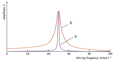

This is the figure we we given. I calculated Q using ω/Δω
where Δω is the width of its peak at its halfway point
For oscillator B, I took that to be ω=50 and Δω to be (55-45)= 10
In actual fact the Q factor should be 5 but again, its less than 6.3
Have I made an error somewhere?
I don't immediately see an error in the way you calculated the Q value. A Q value of 5 still means that the oscillator is critically damped and will not finish even one cycle. Could you post the problem text in its entirety?

1. Taking measurements from Figure 1, determine the value of Q for each of the oscillators represented. Explain how you obtained your answer.
Where Q= ω/Δω
2. Using equation 5.19 which is the rate at which the mass–spring system loses energy to its surroundings is referred
to as the Q-value for the oscillator. The Q-value is defined as:
Q=2π (E/ΔE) Eq 5.19
(Underneath the equation, this is also stated. ΔE/E is the fractional energy loss per cycle of the oscillation)Calculate how much original energy each of the oscillators in question 1 will have left after three cycles.
Seems a bit contradictory!
My guess is that it's a trick question. If you show that oscillator B cannot possibly finish even a single cycle (without being driven by an external source), and explain your answer, it should be good. The drawing you've been given is not very detailed and quite rudimentary, giving you room for interpretation.

The question states:
Using equation Q=2π (E/ΔE) calculate how much original energy each of the oscillators will have left after three cycles.
Where ΔE/E is the fractional energy loss per cycle of the oscillation.
As the question asks how much original energy would be left after 3 cycles, I assumed Q could not be greater than 2π, otherwise all the energy would be dissipated before one cycle. The problem was due to the graph being difficult to read, I had measured Q to be 5.
