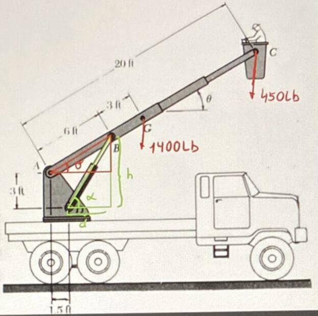

The ABC telescopic extension arm is used to lift a worker to the height of overhead, telephone and electrical cables. For the indicated extension, the centre of gravity of the ##1400\, \textrm{lb}##-arm is at the ##G##-point. The worker, the basket and the fixed equipment in the basket weigh ##450\, \textrm{lb}## and their combined centre of gravity is at point ##C##. For the given position, determine the force exerted at ##B## by the single hydraulic jack using when ##\theta =35\, \textrm{º}##.
Solution: ##\vec{F}_{DB}=6490\, \textrm{lb}\,\,\, 62,1\, \textrm{º}##
##\sum M=0##
Figure:
My attempt at a solution:
For the calculation of ##F_{DB}## we consider the equilibrium in the whole machine.
$$\left. \begin{array}{r}
h\rightarrow h=6\cdot \sin \theta +3=6,44\, \textrm{ft} \\
d\rightarrow d=6\cos \theta -1,5=3,41\, \textrm{ft}
\end{array}\right\} \,\, \alpha =\arctan \left( \dfrac{h}{d}\right) =62,1\, \textrm{º}$$
$$\sum M_A=0\rightarrow -9\cos \theta G-20\cos \theta C+F_{DB}\cos \alpha \cdot 3+F_{DB}\sin \alpha \cdot 1,6$$
$$\rightarrow \boxed{F_{DB}=6482,5\, \textrm{lb}}$$
I don't understand the lever arm length 1,6 used on the right. Shouldn't it be 1,5? Maybe a typo when posting.
For the answer, I get 6480, almost exactly.

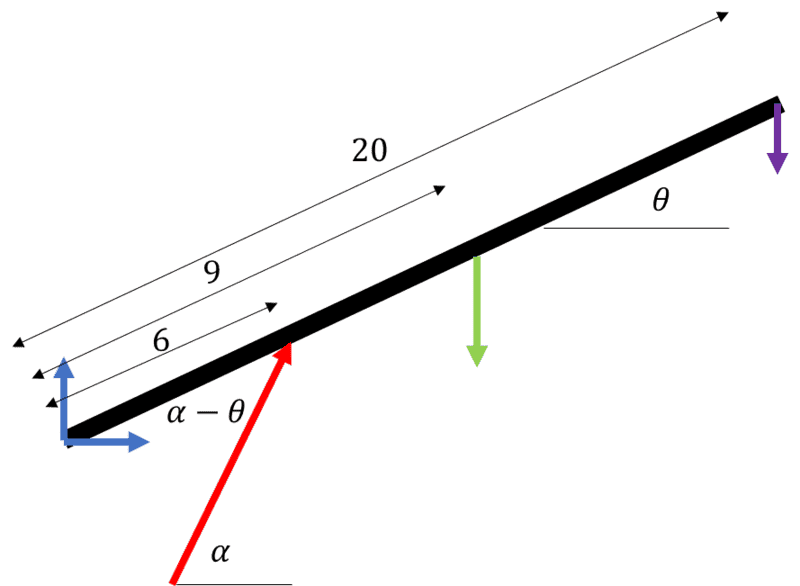

$$ \circlearrowleft^+ \sum M_A = 0 = -9 G \cos \theta -20 C \cos \theta + 6 F \sin ( \alpha - \theta) $$
##F \approx 6473 \rm{lb}##

This is the free body diagram of the arm.
Edit: I think I see the intention of the OP now, but if everything is equivalent why the noticeably different results?
erobz said:
Looking carefully at what the OP did, neither of the last two term makes sense to me.
@Guillem_dlc is taking the two force components as being applied at D, though there may be a small error in the arithmetic; see post #5. I took them as applied at B, which gives a different combination of lever arms but should be equivalent. My form is readily converted to yours, so I think all three algebras are fine.

So as far as I can see, there are at least ( @haruspex has a third equivalent) three ways of approaching it that should be equivalent. All three should yield the same result. Yet all three give very noticeably different results from each other (none giving the book result)! There has to be something interesting here that explains this. If it was a difference in decimal places, I'd be un-surprised...but a difference of ##10 \, \rm{lb}## between them?
Likes Lnewqban
The most likely source of rounding error would be in finding alpha then plugging that by hand into trig functions. If you manage to do everything in a single equation typed into a calculator it should keep plenty of digits.
Note that it is not necessary to find alpha as such since the sin and cos can be derived algebraically from tan.
I have now put all my working into a spreadsheet, which keeps 10 or so significant figs, it seems. I get 6480.106…
If we can agree on 6480 then my guess would be that the book's 6490 is a typo.
Are you using a spreadsheet or equivalent? If doing that you still get 6473 please post your values for alpha and its trig functions. I get 1.083323924 radians, cos: 0.4683942052, tan: 1.886273531.
Likes erobz
I get the same thing as you when I use Mathcad. I was using a TI-89, I think the rounding on the ##h## and ##d## that I just pulled from the OP was the culprit. I got 6480 on both now. Mamma mia! :bugeye:
