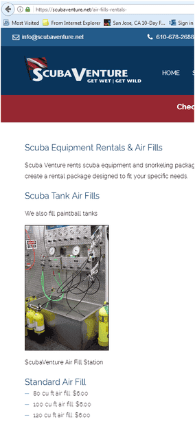

Are you actively cooling the pressure vessel while you fill it? If not, the final pressure will be lower after you stop filling it and it cools off...
That's one reason why scuba tanks are usually filled in a water bath (the other being explosion safety)...
Likes Lnewqban
I am not, but the volume of the vessel and the low fill rate do not seem to elevate the temperature of the vessel much at all. I'm really just trying to come up with a "rough" fill rate to use as metric for compressor performance against a load.
Likes Lnewqban and berkeman
I am with you 100%. I have 88CF bottles as well, and I agree that when you step up the fill rate, that contraction can be quite noticeable. The small vessel I'm talking about would be challenging to remove and fill, and the temperature delta with a 6 min fill is not large at all. Good advice to be sure, but not really much of a concern in this specific case. Just looking for a way to back calculate an average fill rate so I can compare compressor performance.
Likes berkeman
