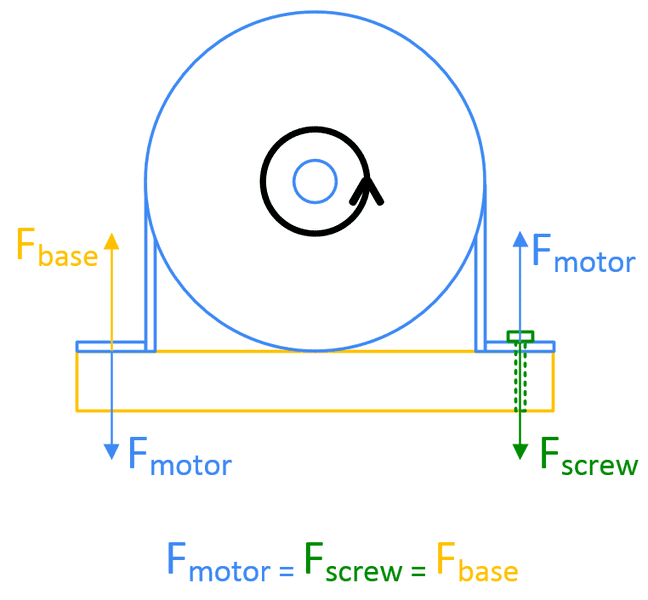

When a motor with a flywheel spins up and then stops, what is the force translated on the surface onto which the motor is connected? I'm assuming the value of this force equals to the centripetal force in the flywheel, but I'm not sure.
The setup: http://imgur.com/IiOrRoQ

Can you draw a free body diagram? Do you know Newtons third law? Are you familiar with the term 'static equilibrium'?

I made the FBD, but I'm not sure what information I could get out of it, since I need to find F_motor as a function of flywheel mass and speed.

Torque is defined as T=Fr. The motor casing is not accelerating so all torques and forces must sum to zero.
if we call the horizontal distance between the shaft axis and a mounting bolt 'r' then we have:
(letting anticlockwise be positive)
ΣT = 0 = Fbaser + Fscrewr - Tmotor
So as r gets larger, the force on the screw gets smaller.
Nice diagram.
The speed of the flywheel doesn't matter. What matters is the torque the motor applies to it's load.

That's right. But more directly,The force depends on the braking torque the motor applies to the flywheel.

When the motor applies a braking torque to the flywheel the motor must apply force to its mount as in post #4.
