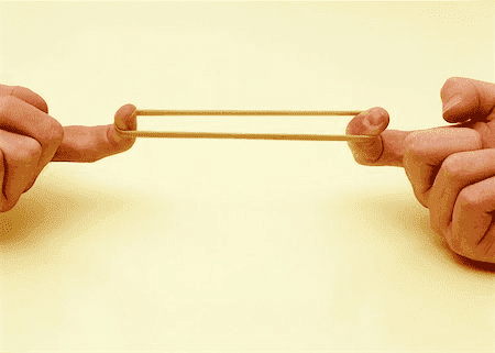

Thank-you everyone who popped in. I don't think I was clear. Let me try again.
What I don't understand is this.
This is clearly possible:
When I see that, I see a straight line. I don't see the catenary. Is it still there, but so small that it can not be seen or is that a straight line?
And if that is a straight line, then theoretically is it possible to do the same thing over longer distances.
And if it is theoretically possible to do that over a long distance, is there a way to demonstrate this in reality?
And if the bungee cord does not have the tensile strength to mass ratio to achieve this, would anyone know of a material strong enough and light enough to accomplish my goal of creating a straight line over distance?
Or is that simply a mathematical impossibility regardless of the mass to tensile strength ratio?
Or am I looking at this all wrong still?
Thanks again for any help, folks.

Yes. If the line were exactly horizontal, the force from tension would be purely horizontal and there would be no vertical force to support the cord in the middle of the span.
Assume that 100% elongation is achieved at the nominal 100 pound working strength of the 1/8 inch bungee cord and that 1000 feet (unstretched) bungee weighs 9 pounds. Then each end of the span needs to support half the weight of the cord -- 4.5 pounds each. The sag angle at both ends must then be ##\sin^{-1} \frac{4.5}{100}##. That is about 2.5 degrees. But we do not need the angle. We'll be taking its sine in a moment anyway. So we just need the sine: ##\frac{4.5}{100}=0.045##
If we imagine this cord extended to a stretched length of 2000 feet in a perfect V then the sag at the bottom of the V would be 1000 * 0.045 = 45 feet. But since the actual span will be a curve, we can guesstimate a true sag of about half that. Call it twenty or twenty-five feet.

Thank-you, I'm getting it, and bungee is clearly not going to work.
I am wondering if we attempted the same thing with fishing braid that does not stretch (or just barely); how much we could reduce the catenary sag.
Could we calculate the amount of sag if we used this for 5000 feet?

fascinated said:
Does it become straight for even a moment before breaking?
No. No amount of force can flatten the line. It is impossible.
If you want to convert this from a mathematical impossibility into an engineering challenge, you will have to reveal what you are actually trying to do and how close to "flat" might achieve the goals that you have not shared with us.
