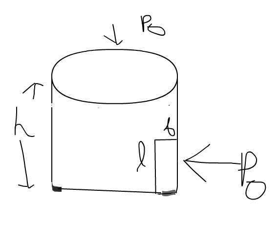

In summary, the side wall of a wide vertical cylindrical vessel of height 75 cm has a narrow vertical slit running all the way to the bottom of the vessel. The length of slit is 50 cm and width b = 0.1 cm. With the slit closed, the vessel is filled with water. Immediately after the slit is opened, the resultant force of reaction of the water flowing out of the vessel is 4.9 N.
Raghav Gupta
1,011
76
The side wall of a wide vertical cylindrical vessel of height , h = 75 cm has a narrow vertical slit running all the way to the bottom of the vessel. The length of slit is l = 50 cm and width b = 0.1 cm. With the slit closed, the vessel is filled with water. What is the resultant force of reaction of the water flowing out of the vessel immediately after the slit is opened?
A. 4.9 N
B. 0.49 N
C. 49 N
D. 490 N
P = P0 + ρgh
F = PA
g = 9.8 m/s2
ρ = 103kg/m3
b = 10-3m
h = 3/4 m
l = 1/2 m
The P0 will be canceled as outside pressure is also P0
$$ F = \int_0^l bρg(h-l)dl $$
## F = bρg [hl - \frac{l^2}{2} ] ##
⇒ F= 9.8 /4 = 2.45 N
Where is the flaw?
Why I am getting a wrong answer?

Chet, can you explain what is wrong with the analysis adopted by both Raghav and me? Prior to removal of the strip, the water exerted a force on the strip of 2.45N. The instant the strip is removed, that force is no longer exerted, but all the other forces on the container remain. So the reaction force should be 2.45N.
To make the Torricelli solution correct, it should have asked for the force when the flow is established but the level has barely fallen.
Likes Raghav Gupta and Chestermiller
I agree. The problem is poorly posed.

Thanks guys.
I posted this problem since I was amazed that why my attempt was giving a solution not in options and I tried and tried but still same 2.45 N, but I see the solution which they have given is interpreting something else.
