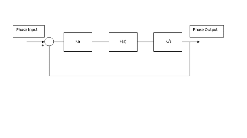

I have a linear model of a phase detector (phase lock loop) represented by the block diagram below. It is designed to maintain zero difference in phase between the input carrier signal and a local voltage controlled oscillator.
Phase demand→Ka→F(s)→K/s→Phase output
F(s) = 10(s+10)/(s+1)(s+100)
We want to minimise the steady state error for a ramp change in the phase information signal.
Can anyone help determine the limiting value of the gain KaK = Kv in order to maintain a stable system.
We usually work with the open-loop function of the system when determining its margins for closed-loop stability. I assume you're showing the closed-loop function since there's no feedback loop included. Maybe you could show a block diagram of your system before any reductions are made and we can go from there?
The system you have shown has infinite gain margin, be it in open or closed loop.
I've attached a more accurate block diagram which has the feedback look included.

Right, are you familiar with root-locus and/or frequency-response analysis?
I have been trying to use the root locus approach, I'm not sure about frequency response. I worked the closed loop transfer function to 100K2/(s+1)(s+100)+K and then used the quadratic formula to try and obtain roots getting -50.5≠.5√9801-4k. The steady state error acceptable is 1° for a ramp signal of 100rad/s. I am confused at how to go about calculating gain for a ramp change compared with a step change.
First thing, I think you took a wrong turn somewhere in calculating the closed-loop transfer function. You could show the details of your work if you want some pointers, but you're going to end up having to find the roots of a cubic polynomial. That's not an intractable problem per se, but root-locus analysis is, in large part, about finding the locus of the roots of the characteristic polynomial without having to actually solve it analytically (which can be hard to impossible).
It's difficult to see on this plot since I have no idea how to set the gain and axis limits manually, but hopefully it will give you the basic idea. The locus never enters the right-half plane, i.e. your system is stable for any gain.
