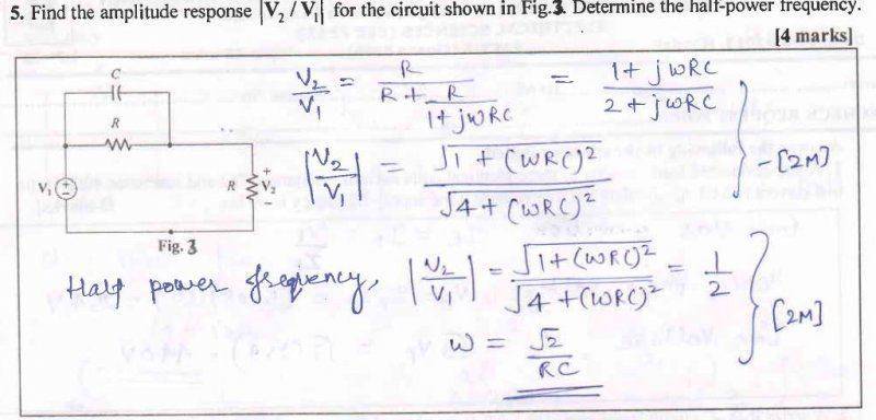

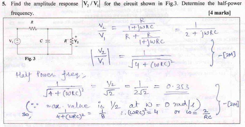

For first problem:
##\cfrac{|V_2|}{|V_1|} = \cfrac{1}{\sqrt{4+(\omega RC)^2}}##
For second problem:
##\cfrac{|V_2|}{|V_1|} = \cfrac{\sqrt{1+(\omega RC)^2}}{\sqrt{4 + (\omega RC)^2}}##
I have to calculate half power frequency for both cases.
At half power frequency, power absorbed by circuit = max power/2
[/B]
I cannot understand why the problem was solved differently in both cases. In first problem,##\cfrac{V_2}{V_1}## was set to ##\cfrac{1}{2\sqrt{2}}## and in the second problem it was set to ##\cfrac{1}{2}##. While in both problems, max value of ##\cfrac{V_2}{V_1}## occurs at ##\omega = 0## and is equal to ##\cfrac{1}{2}##.
Can someone please clear this doubt?
Thanks

Svein said:
Power = Voltage * Current
Thanks for the reply. But, I didn't get you. I am familiar with that formula. I understand that we use that formula to substitute ##\cfrac{|V_2|}{|V_1|} = \cfrac{1}{\sqrt{2}}## but how does it explain the ##\cfrac{1}{2\sqrt{2}}## part ?
Thanks again.
When the impedance is reduced, the current increases. Thus the power ratio is not equal to the voltage ratio.
Thanks
Check again the frequency and maximum output for the second circuit. How do capacitors behave with frequency?
For the second solution shown, I think the magnitude of the voltage ratio should have been set to ##\frac{1}{\sqrt{2}}## rather than ##\frac{1}{2}##
Thanks for the reply. I think I got it. The max output should be 1 when ##\omega \rightarrow \infty##?
Yup. The capacitor starts to look like a short at high frequencies.
