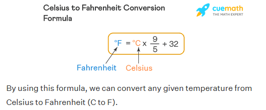

Every F degree is ##\frac{9}{5}## multiplied by a C degree (or K degree).
https://www.cuemath.com/c-to-f-formula/
correct, i do know this equation. and i THOUGHT that is what i used.... or maybe i didnt haha.
Yes, 1 degree increase of C is 1 unit increase of kelvin.
So if my dT is only changing by 1 k, that means the temp change was 1 C as well, meaning the increase was from 32 C to 33C based upon the original problem, regardless of the high mach number. IE if my launch day was 32C (90F) then during the flight, the change in temp would be 1 C so final temp would be 33C or 91.4 degrees F

No. If dT = 1[K] = 1[C], then in Fahrenheit it is dT = ##\frac{9}{5}[F/K]~1[K]## = ##\frac{9}{5}[F]##

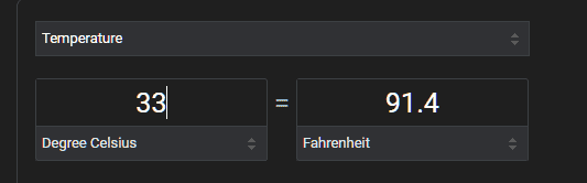

ok, so if my launch day was 32C (90F) and the change in temp was 1 C, meaning the new temp was now 33C, that would mean the temp was 91.4 degrees F?
Or is the change in temp only referring to the material itself since thats the Cp we are using? so whatever tmep the material was at the beginning of the launch, would experience a 1C change in temp or a 9/5ths F
9/5=1.8. So if the ambient temp was 90F, the increased temperature would be 91.8F.
Likes LT72884
google must round differently is all. There 32 was 90.. But really it shold be 89.6
oh well
