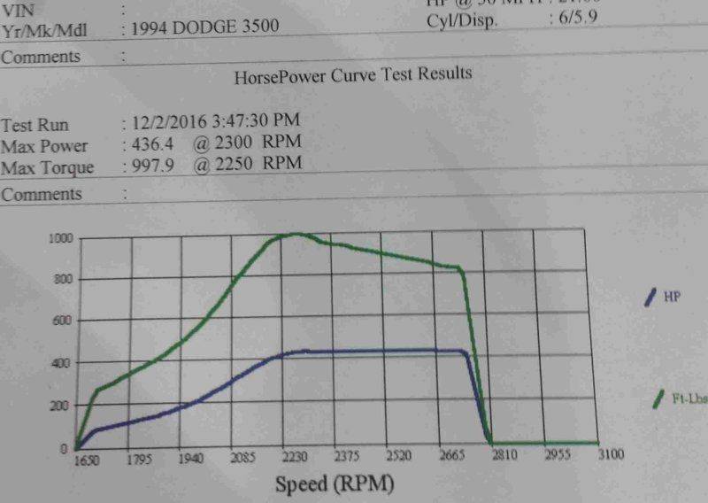

Thought I'd update this.. I had my truck on a dynamometer in December, and found out a few things.. like my fuel pressure drops dramatically and I have to do some upgrades there.. it also led to an interesting dyno graph.. There were also some other little problems.. like when they make the dyno learn engine RPM from wheel speed, they weren't very accurate about it which throws the torque/RPM numbers off.. I believe the RPM on the graph is about 10% below actual, inflating the torque number (I know the truck revved to 3000+ RPM).
You can also see where the limit of the fuel delivery is.. right at 436 hp, it just stays flat and really doesn't drop at all like most dyno charts, this suggests to me that the truck could easily achieve much higher power levels with adequate fuel... The existing system was able to deliver 436 hp worth of fuel, and that was it
Meanwhile, since the trap speed equations said 487 hp and the dyno says 437, the trap speed equation may be adjusted to provide engine output, rather than wheel HP, and then it would actually be pretty close.
I also know that my truck with a manual transmission shifts SLOW, and that with an automatic I could have saved a lot of time and gained several MPH... Since then, I've changed the rear end gear ratio to 3.54 from 4.10, and put a 6 speed manual instead of the 5 speed.. the gears may help me, but the 6 speed will not.. at least not on the track, but it's MUCH better for driving and towing, which is the real job of this vehicle
