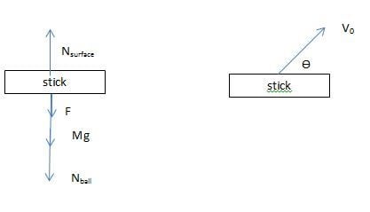

Stick of mass M resting on frictional surface with friction coefficients μks. From the center of the stick at time t=0 a ball of mass m thrown to the right with an angle θ above the horizontal and with speed v0. As a result of the throwing there is an impulse on the y axis (perpendicular to the horizontal stick) between the stick and the surface for short time Δt.
Calculate the impulse of the normal force between the surface and the stick. Assume the interaction time is short Δt→0?
How am I formulate the equation- 1. When I calculate the change in momentum is pf=0 because the stick does not move vertically? 2. Is the acting force on the stick is F=N(t)−Mg because the normal on M by the ball is internal force?

I thought that the change in momentum is 0-(-mv0sinθ), and when I show the forces that act on the stick N will change because the N that come from the ball will stop acting when the ball will be thrown, so F=N(t)-Mg.
The question is about momentum, not forces. In time Δt, the momentum from the weight of the stick is MgΔt, but what happens to that as Δt → 0 ?
You have the right change in vertical momentum for the ball. The only other vertical impulse is between the stick and the ground, so the magnitude of that must be...?

It depends what you mean by normal force here. There was presumably an ongoing normal force equal to mg before the ball was thrown. During the Δt of the throwing event, its contribution to momentum changes is mgΔt, which is negligible. The throw itself would have involved a much larger force acting for the short time Δt. We don't care how large exactly that force was, or whether it was constant. All we care about is that the integral of the force over the brief duration of the throw gave the ball a certain vertical momentum. Since the stick neither becomes airborne nor sinks into the ground, the same impulse must have operated between the stick and the ground.
