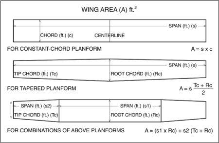

It's clear from your diagram that you are having trouble understanding how an airplane looks in plan view.
The fuselage is the body of the airplane, which is occupied by passengers and/or cargo. It's the structure to which the wings are attached. In other words, the wings stick out from the sides of the fuselage.
The wingspan is the total distance measured from wing tip to wing tip, and this distance runs perpendicular to the centerline of the fuselage.
This diagram might help envision the wing layout rather than using wordy explanations:
Instead of having the wing tips squared off as shown in the diagram above, lay out a circle of radius = 2 feet such that the center of the circle lies at the mid-chord line of the wing plan. The leading and trailing edges of the wing will connect the ends of the root chord and be tangent to this circle. You could probably use a lot of math to calculate these intersections, but making a simple sketch to scale on a piece of paper would be quicker and more accurate.

The problem states that the tapered wing has the same area as the rectangular wing, so the total area is known. You also know that the root is 6 feet, the tip is 4 feet, with a 2 foot radius semi-circle attached to each tip. You can calculate the area of a semi circle based on it's 2 foot radius. Then subtract that from the total area (per wing), to get the area for the trapezoid portion of the wing, then use the formula for trapezoid area to get the span of the trapezoid portion of each wing. Then the total span for each wing equals the trapezoid portion plus the 2 foot radius of the semi-circle at the wing tip.

Wow! Thanks for that! I got it. I was confused for the usage of the given data about the fuselage. Anyway, I used 3.82 instead of 4 for the tip of the chord. Because of the tangential line. Is that okay? But the area of the circle will also change. Do I need to stick with 4ft tip?
Here is my solution:
Wing area = 216
Root chord = 6
Tip chord = 3.82
Area of the sector = 7.4814
Area of trapezoid = 216 - 7.4814 = 208.5186
Altitude of the trapezoid as the wing span = 42.3625 + 2 ft radius = 44.3625
THANKSSSS! :)
The problem states it's a 2 foot radius circle. It doesn't state how the wing tapers, so you could assume it tapers equally from the leading and trailing edges, so the chord at the base of the semi-circle would be 4 feet. Normally, a "wing span" includes the diameter of the fuselage, but the wing area does not.

Aspect ratio = wing span / chord or Aspect ratio = wing span ^2 / wing area
Which do I need to use in terms of exact computation? Because using both computation has a minimal difference on Drag. But for the computation of Coefficient of induced Drag, difference in decimal value matters.
Coefficient of induced Drag = (coefficient of lift)^2 / (pi x AR)
ChimM said:
Aspect ratio = wing_span / average_chord or Aspect ratio = wing_span ^2 / wing_area
These are the same:
AR = wing_span^2 / wing_area = wing_span^2 / (wing_span x average_chord) = wing_span / average_chord
