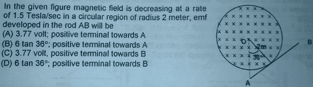

In the below figure, magnetic field is decreasing at a rate of 1.5T/s in a circular region of radius 2m. EMF developed in the rod will be?
$$V_{\text{induced}}=-A\frac{\mathrm{d}B}{\mathrm{d}t}$$
I tried using induced electric fields. They will be concentric circles and its magnitude is given by $$E=-\frac{r^2}{R^2}\frac{\mathrm{d}B}{\mathrm{d}t}$$ (where ##r## is the radius of the circular region and ##R## is the radius of the circular electric field) I took the components of this electric field along the rod and then tried to used $$V=\int E_rdr$$ But finding ##E_r## is difficult. There will be two points on the rod which cut the circular electric field. What should be my approach?

The solution says that 1/5th of flux says through OAB. They solved the question in a single step while I am still stuck. How did they get 1/5?
A ?
The ends of rods are A and B
Very practical, with an A and a B for Area and magnetic field. Where is B ?
Well, at least that should pin down the position of B (end of rod).
Interesting that there is a one step solution. I figured we were heading for some real work. Can you post it ? (This time I don't mind a picture...)

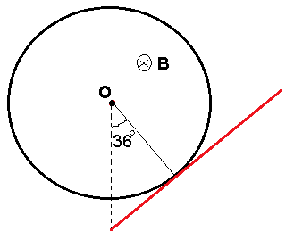

If we can somehow prove that triangle BOX = 36 degrees.
Then yes, flux passing through AOB will be 1/5th of the total flux as 72 × 5= 360
(I am not sure though)
Likes Titan97
We can't prove that. It should be shown in the diagram. I guess there's a misprint?
Likes Titan97
We assume ##\angle OBA = 54^\circ## as well and proceed.
The bright idea (that I missed too o:) ) is to construct a Faraday loop BOAB where you know the induced emf and where you know the contributions from BO and AO are zero (why ? :smile: ).

The electric field can be determined for each r>R using Stokes law. (Draw a separate circle of radius r and let the circle and compute E which is tangent to the circle at each point.) Then you can find r as a function of ## \theta ## where each circle of radius r crosses the line. I think the trigonometric factors in computing the integral of E*ds cancel with a simple ## d\theta ## result. This longer integral approach can be shortened just by applying Stoke's law as mentioned above. It appears it doesn't even need to be a straight line path and Stokes law will give the same answer for the EMF for any path from A to B that stays outside of R.
The electric field lines cutting OA and OB will be circular in nature, hence the field direction at each point will be perpendicular to OA and OB. So, there will be no emf in OA and OB. Hence, emf is developed only in rod AB.
