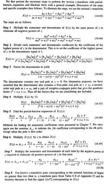

This is the instruction from the book :
But it does not say if this method can be applied for the fraction which has the order of numerator is equal or larger than denominator.
Can I use the above method to find z-inverse of following fraction (order of numerator is larger and/or equal)
[itex]X(z)=\frac{4-z^{-1}}{2-2z^{-1}+z^{-2}}[/itex]
[itex]X(z)=\frac{2+z^{-1}+z^{-2}}{1+0.4z^{-1}+0.4z^{-2}}[/itex]
[itex]X(z)=\frac{z^{-2}+z^{-1}}{z^{-3}-z^{-2}+2z^{-1}+1}[/itex]
That is not the case with your z transform. F(z) = Az/(z-γ)2 has order of denominator > order of numerator.
You can rewrire F(z) = Az-1/(1 - γz-1)2.
I see nothing wrong with your instructions. If your table includes that expression then just follow it!
You seem to have a good z transform table!
Yes, the instruction works for the problem in my first post. But i am wondering if it works for the function like this :
The numerator's lowest order is (-1), the denominator has (-2) as a lowest order. Can I multiply both numerator and denominator with z2 and do the rest using same method ? In the instruction the order is (-6) and (-5) respectively, so I am not sure if I can follow 8 steps for the above function.
