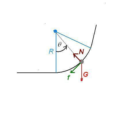

You can consider the body point-like, moving along an arc of circle. Gravity G, normal force N, and friction f act on the body. Find the resultant tangential and radial force in terms of θ, the angle of the turn. You get a differential equation for v2.

We do not know a lot of things so the problem in this form has no sense. We can interpret it in different ways.
If the body rolls, the static friction is b less or equal μ times the normal force along the path, but the mechanical energy is conserved.
If the body slides, the force of friction is μ times the normal force, and it does work.
In both cases, we need to know the normal force. As it is a curved path, the normal force depends of the speed and the radius of the curvature.

While the body is moving along an arc of a circle it is affected by radial force equal to ##N##, so:
##N=m\frac{v^2}{R}##
##mg⋅cosα=m\frac{v^2}{R}##
##g⋅cosα=\frac{v^2}{R}##
It is also affected by tangential force which is equal to downward directed forces:
##F_T=F_{fr}+mg⋅sinα=μmg⋅cosα+mg⋅sinα##
##a_T=g(μ⋅cosα+sinα)##
I am not really sure what to do now.

That is not correct. The centripetal force is the resultant of the normal force and the radial component of gravity.

The expression for the force of friction is not right. The force of friction is μ times the normal force, which is not mgcosα now.
If you have the correct expression for the tangential force, you can write the tangential acceleration, which is dv/dt (v is the speed).
If centripetal force is the resultant of the normal force and the radial component of gravity, so:

What do you mean on 'radial force'?
The normal force is N. The centripetal force is mv2/R which is the same as mω2R.
The resultant of the normal force and the radial component of gravity is equal to the centripetal force: N-mgcosθ=mω2R.
I see, so ##N=mω^2R+mgcosα##, then the tangential force is equal to:
##F_T=μ(mω^2R+mgcosα)+mgsinα##
##a_T=μ(ω^2R+gcosα)+gsinα##

It is almost right now, but the tangential force opposes the motion, so it needs a negative sign. And you should use some other angle, (say θ), as alpha is the angle corresponding to the final position, The tangential acceleration can be written in terms of the angular acceleration ##a_T=R \dot \omega ##
So the equation becomes ##R\dot \omega=-μ(ω^2R+gcos(\theta)-gsin(\theta) ##.
This is a differential equation for omega. Are you familiar with differential equations?

The equation
##R\dot \omega=-μ(ω^2R+gcos(\theta))-gsin(\theta)##
is for ω(t), angular velocity in terms of the time. But you need the KE in terms of the angle. The equation does not depend explicitly on time so you can change the variable to θ. Apply chain rule and express dω/dt with dω/dθ.
I am having a hard time understanding this. Is this correct:
##R(ω(ω(θ)))=-μ(ω^2R+gcos(θ))-gsin(θ)##
I do not see what you mean.
You know that ω=dθ/dt.
By the chain rule, dω/dt = (dω/dθ)(dθ/dt)= (dω/dθ) ω.
With that, the original equation transforms into
##Rω \frac{dω}{dθ} = -μ(ω^2R+gcos(θ))-gsin(θ)##, a differential equation for ω(θ).
The left side can be written as (1/2) d(ω2 )dθ. You can consider the ω2 = z the dependent variable instead of ω. So we arrived at the equation
##0.5Rz'= -μ(zR+gcos(θ))-gsin(θ)##
Rearranged:
##z' + 2μz =-\frac{2g}{R}\left(μ\cos(θ)+g\sin(θ)\right)##
It is a first-order linear differential equation for z. Do you know how to solve such equations?

As the radius of curvature is not given, the intended answer must be independent of it. This is not true in general - even without friction the loss to gravity will depend on R. It is true if we let R be very small and treat the mass as (non-rolling) point, however. That leads to a unique solution that depends on the given quantities only. Not sure if you can get away without integration, but it certainly makes the equations easier.
  • #34
So you suggest to solve the problem for the limiting case R-->0, but still assuming smooth transition between the two planes.
In case of very small radius, the transition from one plane to the other happens in a very short time. It is collision, in principle. The normal force is impulsive, and gravity can be ignored with respect to it. Friction is also impulsive, as it it proportional to the normal force. The change of kinetic energy is equal to the work of all forces. The work of the normal force is zero, The work of gravity can be ignored, so it is the work of friction alone to be counted with.
The change of KE is equal to the work of friction ##dE= -μN(Rdθ)## and N is equal to the centripetal force if mg is ignored : ##N=\frac{mv^2}{R}##, so
##dE= -μ\frac{mv^2}{R}(Rdθ) = -μmv^2dθ##.
##E=1/2 mv^2##, so we can write a DE for the kinetic energy:
##\frac{dE}{dθ} = -2μE##.
It is very easy to solve and get the kinetic energy at the final angle α.
