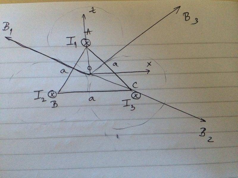

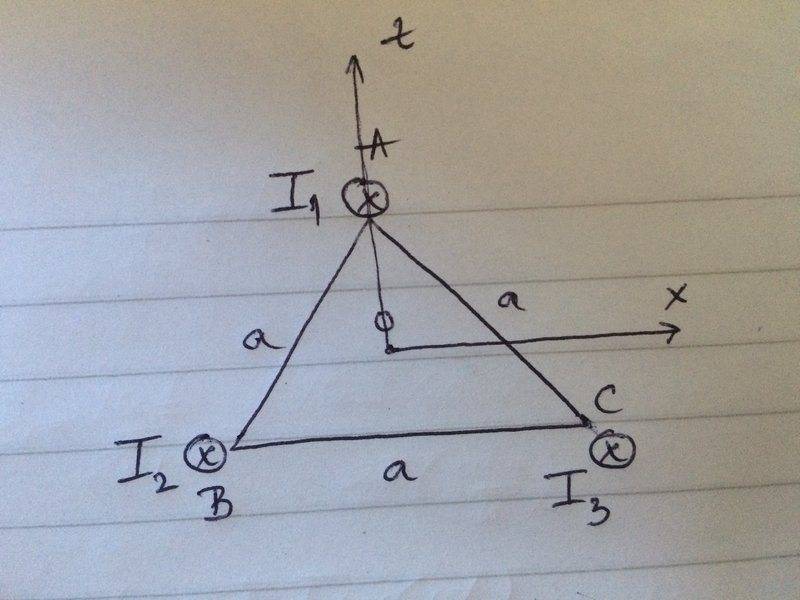

Three very long parallel conductors situated in the air make a direct-symmetrical 3-Phase system. The conductors pass through the A B C points of the triangle of side ##a##. The currents in the conductor form a direct-symmetrical 3-Phase system. Effective values of currents are ##I## and the frequency is ##w##. The phase of current 1 is ##Ψ_1 = 0##.
a) Calculate the vector of magnetic induction ##B## in the point ##O##.
b) What does that vector inscribe over time?
3. The Attempt at a Solution [/B]
The currents in a 3-Phase direct system have a relation
##I_1 = I_m\cos {wt} = I\sqrt2\cos {wt}##
##I_2 = I_m\cos (wt - 2\pi/3) = I\sqrt2\cos (wt - 2\pi/3)##
##I_3 = I_m\cos (wt + 2\pi/3) = I\sqrt2\cos (wt + 2\pi/3)##
Magnetic Induction of a very long straight wire is ##B=\frac{μ_0I}{2\pi r}##
The distance of every wire to the point ##O## is ##r = \frac{a}{2\sqrt2}##
From the wires we only get ##B_z## and ##B_x## since ##B_y = 0##. The angles to the axis is ##\pi/4## (This I assumed).
##B_1 = \frac{\sqrt2μ_0I\sqrt2\cos {wt}}{\pi a}##
##B_2 = \frac{\sqrt2μ_0I\sqrt2\cos (wt - 2\pi/3)}{\pi a}##
##B_3 = \frac{\sqrt2μ_0I\sqrt2\cos (wt + 2\pi/3)}{\pi a}##
Total ##B_x## should then be:
##B_x = B_2*\sqrt2/2 + B_3*\sqrt2/2 - B_1*\sqrt2/2## and ##B_z##:
##B_z = B_1*\sqrt2/2 + B_3*\sqrt2/2 - B_2*\sqrt2/2##
Inserting: ##B_x = \frac{\sqrt2μ_0I\sqrt2\cos (wt - 2\pi/3)}{\pi a}*\sqrt2/2 + \frac{\sqrt2μ_0I\sqrt2\cos (wt + 2\pi/3)}{\pi a}*\sqrt2/2 - \frac{\sqrt2μ_0I\sqrt2\cos {wt}}{\pi a}*\sqrt2/2##, ##B_y = \frac{\sqrt2μ_0I\sqrt2\cos {wt}}{\pi a}*\sqrt2/2 + \frac{\sqrt2μ_0I\sqrt2\cos (wt + 2\pi/3)}{\pi a}*\sqrt2/2 - \frac{\sqrt2μ_0I\sqrt2\cos (wt - 2\pi/3)}{\pi a}*\sqrt2/2##
This seems overly complicated and doesn't seem to match the solution which is simple
Did i assume wrongly that the angle is ##\frac{\pi}{4}##. The angle of ##\frac{\pi}{6}## has ##\sqrt3## and that could result in this ##\sqrt6## shown in the answer. Or is it something else?

It looks like you have drawn the magnetic field vectors incorrectly. They should be perpendicular to the vector from each wire to the center of the triangle, not perpendicular to the side of the triangle.

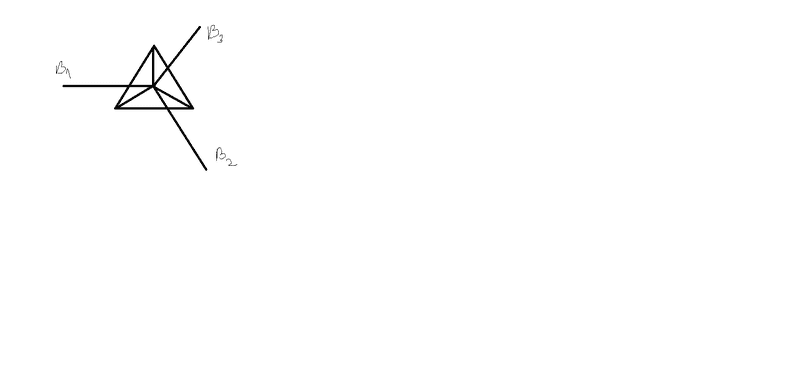

You mean like this?
Yes. Remember that the magnetic field lines form circles centered at the wire that generates them. Therefore, at the point of interest they are tangent to the circle and perpendicular to the radius.
