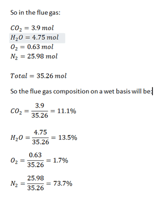

This can't be done unless you know the composition or the heat capacity of the fluid gas. Is this the second part of a problem?
Hi,
Yes I have already calculated the flue gas composition, below is what I got:
There is 10% excess air provided in combustion, this is why I have a small amount of oxygen in flue gas.

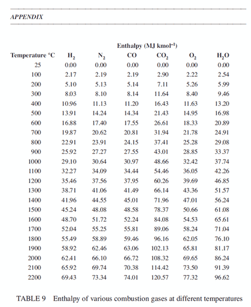

I have been provided with this table, which shows enthalpy of combustion gases.
I used these values when determining my flame temperature by calculating the heat content for each component = number of moles * enthalpy of component
Then added the heat content per combustion gas to give me my total
I calculated the total heat input per kmol of fuel to be 2349 kJ (maybe be right, maybe wrong).
I then used this value to determine my flame temperature, I started with a flame temperature of 1800°C which gave me a total heat content of 2305 kJ.
So I knew my flame temperature was higher, therefore I did the same with a flame temperature of 1900°C.
This gave me a heat content of 2448kJ which is higher than my calculated heat input of 2349 kJ. So my flame temperature was between 1800 and 1900, from these 2 results I produced a straight line graph and ended up with 1832°C.

So look up the heat capacities of these gases at the two extreme temperatures, and take their temperature average. Then take their molar average.
So forget what I said in my previous post. Get the enthalpy change per mole of the mixture between the inlet and outlet temperatures using this table.
Make sense?
The chart below should be kJ kmol-1 not MJ, I think.
sjh94 said:
The specific heat capacity of the flue gas is not given, therefore I am missing 'cph'
So instead of ##c_p \Delta T## you use ##\Delta H## -- much better.
