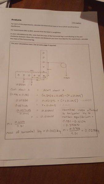

Hey everyone, been stuck on this for over a day now, wondering if anyone is able to tell me if I am on the right track.
1. Homework Statement
"In your calculations for M1 (bell crank lever), note that the mass of the horizontal leg is contributing to the anti-clockwise moment. Given the masses and distances you have recorded for this experiment, calculate the mass of the horizontal leg."
http://imgur.com/a/ETYRT
Above is a diagram of what I am working with, I worked out the mass (0.3924N or 0.04kg) to bring it to equilibrium by physically attaching weights to the horizontal leg and now I am required to work out the mass of the horizontal leg itself. Also the circle of to the right is a pulley.
clockwise moments = anticlockwise moments
F=mg
Sum of moments = 0
Sum of forces = 0
I have attached my attempt in the form of a .pdf. I have tried to lay it all onto a horizontal plane like a beam support drawing because that is what I'm used to working with. The issue I am having is that my answer for the force coming down at the center of mass of the horizontal leg throws the balance of forces out, I end up with more downward force than upward force (which I have put at the pivot point).
Any help would be greatly appreciated.

Just to clarify, we were required to bring this bell crank lever to equilibrium by attaching weights to it (it is pinned to a panel at the shoulder) and now with the information gathered, I need to find the mass of the horizontal leg of the bracket.
Ive also updated the imgur link to have my working on it as well.

You know, I wanted to help out on this problem, but I just could not understand what was happening to be able to help. But I looked again and took some more time.
In summing the moments, for the 0.3924 N force, you multiply that force by a distance of 4. I don't understand what the units are, but it is a distance of 4. But for the 0.981 N force, you are also using a distance of 4. That is what you are using in the equation and that is the number of hash marks in your hand-drawn drawing. If I look at the other figure, for the 0.3924 N force, I can count that it is 4 blue circles away from point A. But for the 0.981 N force, I count that it is 3 blue circles away - not 4. I haven't worked the problem any further than that for now.
Edit: As I look further, you have:
2.3544 = F(2.5)
2.3544/2.5 = 0.9418
A = 0.9418.
Somehow, you switched the F to an A.
Then immediately after that, you wrote:
ΣM = 0 0.3924 + 0.981 - 0.9418 = 0.4316
F = 0.4316 N (with an arrow pointing in the down direction)
= 0.044 kg
You indicate that you are performing a sum of moments, but it is actually a sum of forces, ΣF = 0.
And it looks like it is a sum of vertical forces. But if that is the case (that it is a sum of vertical forces), then why are you adding in the 0.981 N? It looks like the pulley is independent of the L-shaped structure. Is that true, or not true? So it appears that the 0.981 N force is producing a horizontal force on the L-shaped structure - not a vertical force. Do you agree or disagree with that?

Yes I totally agree! I have messed this one up royally, those calculations were after a thought I had in the middle of the night and tried to hash out when I got to work but obviously my brain wasn't all there. I've also realized that because I need to find the weight of the horizontal leg, I can't just put in arbitrary numbers like we had been doing in class or I wouldn't get a 'real' answer.
Really sorry to have wasted your time, I've been going at it the last couple of hours and think I've made some progress.

By arbitrary I mean just counting the holes in the bracket as units, not using the measurements which I completely forgot I had taken, feel pretty stupid.
Because the blue circles are so perfectly evenly spaced, you should have gotten the correct answer even if you had counted holes - provided you had used 3 instead of 4 when calculating the moment about A for the 0.981 force at the pulley. Because you are using the sum of moments equation to calculate a given force, it is only the ratio of the distances that matters - not the particular unit that you use. Your measured distance between holes turned out to be 20 (whatever the units are). And that means the force F should be at a perpendicular distance of (2.5 hole counts)x(20 units/hole count) = 50 units from point A.
You made a few mistakes, but it looks like your method is good.

Ah yes that does make sense, and I see where I've calculated that wrong. Thanks very much for your help.
Questions:
Is the L bracket comprised of a single uniform thickness piece, or two pieces overlapped where they come together? (Perhaps two straight sections overlapped and welded?)
Are you to consider the "horizontal leg" to be the entire horizontal rectangular area, or just the portion that lies beyond the vertical leg edge (the non-overlapping area)? The difference has implications for the total mass of the "leg" and the mass distribution relative to the pivot point.
gneill said:
Questions:
Good point, they are 2 identical pieces overlapping and pinned together at the shoulder
So you'll need to make a decision about what the problem means by the label "lower leg", since where they overlap might be considered as either common to both legs, or not part of the legs, or part of one but not the other.
Can you give us your thoughts on what part of the bracket contributes to the net torque?
