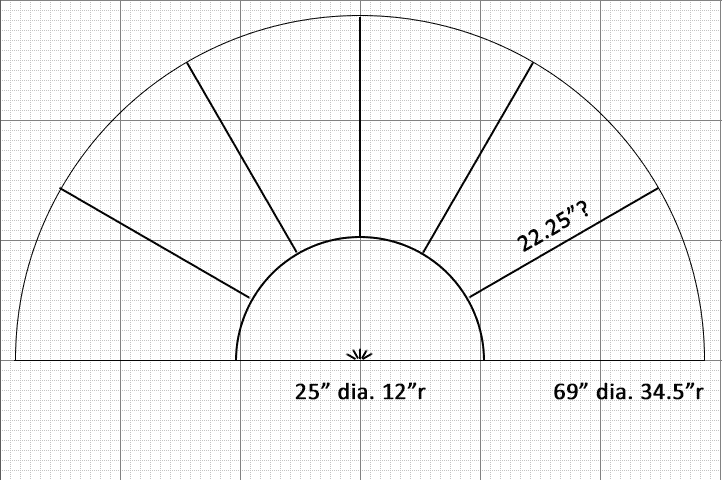

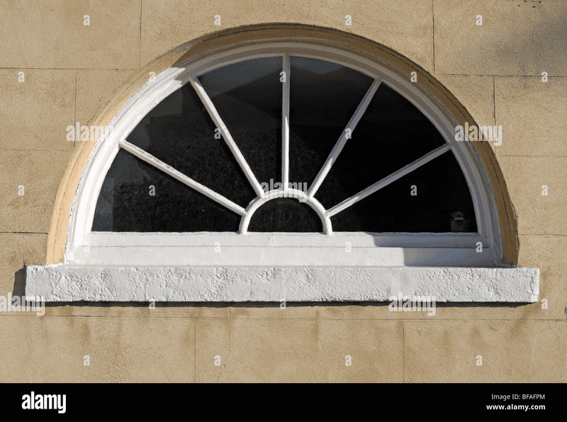

I have a half circle window in my home that I'm trying to cut material for to make a rainbow.
Window across is 69"
All blind slats around the arc are 22.25"
At the bottom of the window there is a Center Circle that is 12 tall and 25 width
What length, width and arc would I need to cut each of the 6 pieces of material?
In advance, Thank you SOOOOO MUCH

This is what we've got so far from your description.
I'm not sure what a blind slat is - I think you are referring to the solid opaque spokes. Presumably, they have a non-zero thickness (unless they really are edge-on metal slats), which will have to be factored in.
There are some other ambiguities:
  • Your measurement of the centre half circle's radius (12") and its diameter (25") disagree by a half inch.
  • The length of the blind slats (22.25") disagrees with the difference of the semicircles (69"-25"=) 22" by a quarter of an inch.
There are likely all resolved because this is a real world object with non-zero thicknesses (thickneces?) but we'll need a pic and/or more measurements.

In a window blind, the slats are the horizontal (or sometimes vertical) thin pieces that rotate through slightly less than 180 degrees to let light in or obstruct its passage through the window.
In your drawing, the 22.25" pieces would be spokes, which is maybe what the OP meant instead of slats. My guess is that the "material" the OP is talking about would be pieces of glass or some kind of plastic in various colors.
If the diameter of the circle is 25" its height (radius) would be 12.5".

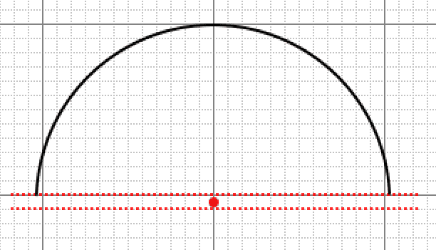

Actually we don't know that. Mathematically, sure. But we do not know that the flat edge of the semi-circle cuts directly through the centre.
This is a semi circle with a diameter of 25" and a radius of 12". (More accurately, it's an arc of about 175 degrees). This is a very real likelihood because of real world objects that have spokes (dotted red line) with non-zero thickness.
We have to go with the OP's measurements (after he double-checks them).
If it's a semicircle, then it's half a circle (described in post #1 as "a half circle window") so the height (a radius) would be half the diameter.
Based on the name and the avatar image (which obviously aren't conclusive), my best guess is "she."
In any case, the drawing and the photograph don't bear much resemblance to a rainbow, in which the colored sections are more-or-less bounded by concentric circular arcs.
I agree that we need to get a lot more clarification from the OP.
Yes. That has been reiterated already, more than once. However, it is also described in post #1 as having a diameter of 25" and a height of 12". That is more specific information than the vague "half circle".
If the "half circle" the OP speaks of is mathematically a 175 degree arc, then both pieces of information can be reconciled.
