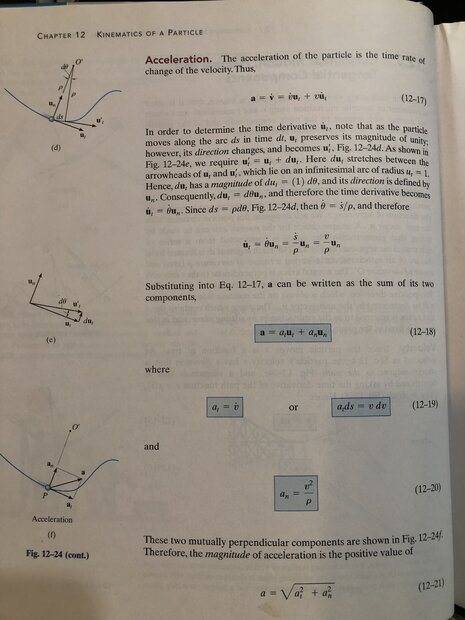

Am I mis-interpreting the author's (R.C. Hibbeler) derivation here?
Notice ##(12-19)##

erobz said:
It's getting worse! Head is spinning! Is it not only the tangential component of the acceleration that contributes to the change in magnitude of the velocity in the ## n-t## coordinates?
Yes, it is. This is so for any motion. But you have something else in what you call kinematic equation.
  • #43
I have eq ##(12-19)## in the above derivation. It represents the magnitude of ##\boldsymbol{a_t}##.
nasu said:
Sorry, my mistake. What I said is true but does not apply to your equation under discussion. I thought that by "kinematic equation" is meant ##dv= a_t dt##.
From what you said above it follows from a simple application of the chain rule:
$$ a_t = \frac{dv}{dt} = \frac{dv}{ds} \frac{ds}{dt} = \frac{dv}{ds} v \implies a_t \, ds = v \, dv $$
Why/Where is this supposedly inapplicable, can someone give a simple example?

I think it hinges on how dv is being defined. See edit in post #38.
