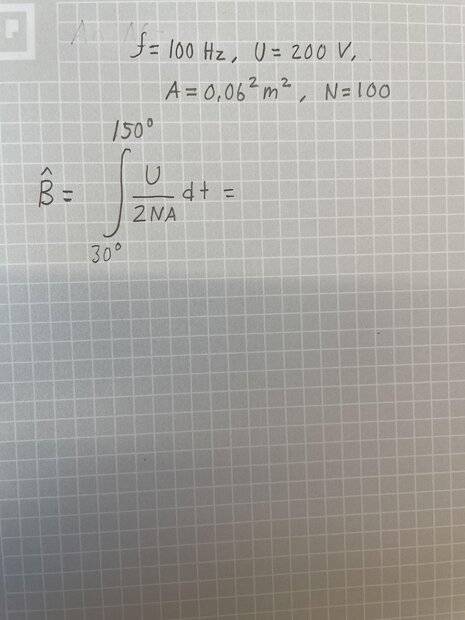

Hi everyone,
I have a EE problem that I need to sort out for alternating voltage. I have to find out the maximum flux density.
B_max= integral from 150 degrees to 30 degrees (u/(2NA) dt is my problem.
I have a hard time to integrate this since I am to integrate with time and not degrees or radians. The frequency f= 100 Hz in this problem(not sure if its relevant).
How do I convert degrees to time? To my knowledge the right answer for 150 degrees should be 25/6 ms to 5/6 ms
Necessary data that's not part of my question but in the problem description: U_max= 200 V, A= 0.06^2 m^2, u=dphi/dt=dNBA/dt
Kind regards

Hi, thank you for your reply.
I think some kind of variable substitution is the way to go. If the angular velocity w= d(alpha)/dt ---> dt= w/(d(alpha)) is possible to put into the integral. However using degrees in integral is giving me a maximum flow of about 36.5 T which is way too high.
Is it possible to convert differently?
I attached the integral and the data, perhaps its clearer to understand the problem

Hi, yes I think the substitution can be of the following form ## \alpha \,=\, \frac{50}{\pi}t## do the differential will be ##d\alpha\,=\,\frac{50}{\pi}dt## and inverting ##dt\,=\, \frac{\pi}{50} d\alpha##, now put it into your integral ... 😄

I tried putting it into the integral. The first try was to convert it to radians and the second to degrees.
I attached my solution and the "right" solution. However I do not get the same answer as below...2021-04-07#2-solution.PNG
Are you sure my attached solution is the way to go?
Kind regards
After 1/100 s you make a full circle -> 360°
Now you can calculate how long you need for 1° respectively 150° etc.
For 150° you''ll get the 25/6 ms
For the 30° it's the same approach.
Likes Ssnow and JoelKTH
Thank you, I got it :D
