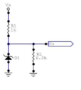

A zener diode D1 is specified to have Vz=3.8V and a knee current of 100 microamps. It is used as a shunt regulator where the minimum load resistance is 6.2k. What is the minimum power source that ensures that the shunt regulator remains regulated?
Vz=(Vzo)+(Iz)(Rz)
I have spent the last hour trying to solve this one, but regardless of how I approached it I could not determine what Vz0 is. If a diode is spezified at Vz=3.8V, and the current its specified at is not given, do we assume this is the knee voltage, or what?
Vz=(Vzo)+(Iz)(Rz)

Anyways, if the question is indeed as you stated, then I think it is rather simple.
The current going through the zener diode will remain at 100uA, and the voltage across it and the load resistor will be 3.8V. Thus I can determine the current through the load resistor as follows,
i=(3.8V)/(6200 ohms)
I can then take this result to determine Vs as follows,
Vs-(i+100uA)(1000 ohms)=3.8
and after carrying out the calculations Vs must be greater or equal to 4.513 V.
If it were lower, it would not provide sufficient current to the zener to provide 3.8V across the resitor.
Hows that?

That's how I would interpret it. Is there a way to check the answer?
Unfortunately not. He posted the exam for students to practice, but with no solutions. Which is essentially useless, hence why I came here in hopes someone could perhaps ensure that I was interpreting his wording correctly, as it is not the same used in my textbook.

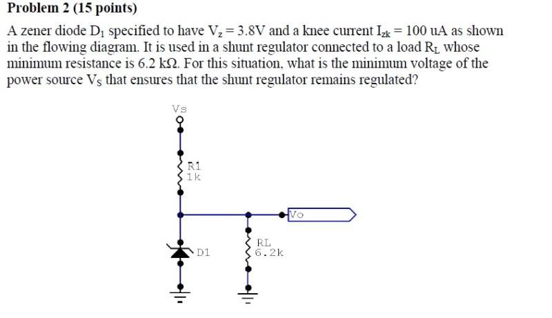

That formula is in my textbook. It is NOT provided with the question, nor is the incremental resistance. ^^^^^^^^^^^ that is the screen shot of the question if you have any doubts.
Yeh, but texdtbooks have text as well as problems. What did the text say about zeners?
The texbook always provides the incremental resistance. For example, "A 9.1 V zener diode exhibits its nominal voltage at a test current of 28 mA. At this current the incremental resistance os specified at 5 -ohm...". From this point we would normally calculate Vzo, which is the point where the line intersects the x-axis, and is usually the "knee" voltage.
Additionally, the textbook always converts the zener diode into a dc voltage source and a resistor rz. The value of the the voltage source is determined from Vz=Vzo+(rz)(Iz), and is equal to Vzo.
I don't see how its possible to use this formula to model the zener in this way. The question on the midterm is poorly worded as it doesn't specify that it is 3.8 V AT 100uA...
I agree. What they should have done is specified Vz at 100 uA, then everything else would not have mattered.

Just looked at another question off the midterm. I think it's safe to say that he is assuming Vz=Vzo. I guess he's not too worried about accuracey. The other question I saw stated the following: Assume ideal op amps are used. Using a zener diode with a breakdown voltage of 5.6 V, design the circuit to produce an output voltage of 10 V. Assume the input voltage is 12 V and the zener diode current is 1 mA.
The other question just isn't very clear with his english...
Here we go again. The question again is, what is Vz at 1 mA? Your guess is as good as mine.
The rest of the problem should be trivial, just an exercise in setting up the correct op amp gain ...
