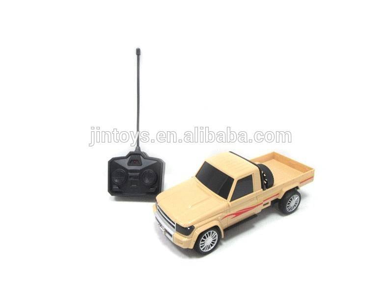

The vehicle will have to travel in a straight line, I was thinking if I use one motor on a single wheel it would make this harder to keep straight.
Steering by only adjusting wheel drive and not wheel angle can be pretty problematic. I'd suggest just starting with something like a simple battery-powered radio-controlled (R/C) car, and implement the pieces yourself as the project...
https://sc01.alicdn.com/kf/UT8PYDTX74bXXagOFbX0/3709/UT8PYDTX74bXXagOFbX0.jpg
