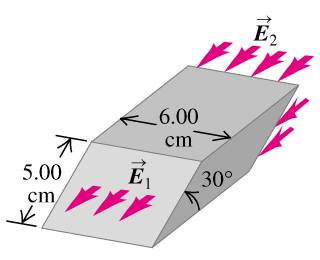

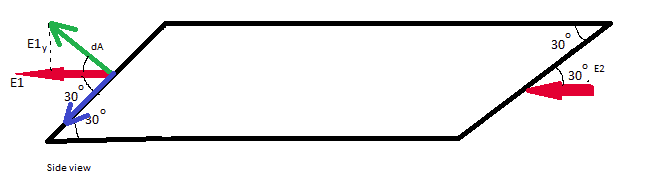

The electric field ##\vec E_1 ## one face of a parallelepiped is uniform over the entire face and is directed out of the face. At the opposite face, the electric field ##\vec E_2 ## is also uniform over the entire face and is directed into that face. The two faces in question are inclined at 30.0° from the horizontal, while ##\vec E_1 ## and ##\vec E_2 ## are both horizontal; ##\vec E_1 ## has a magnitude of ##2.40*10^4 N/C## , and ##\vec E_2 ## has a magnitude of ##7.10*10^4 N/C##.
Assuming that no other electric field lines cross the surfaces of the parallelepiped, determine the net charge contained within.
##\oint \vec E \cdot d \vec A = {\frac{Q}{\epsilon_0}}##
## A = lw ##
##EA = {\frac{Q}{\epsilon_0}}##
##Q = EA\epsilon_0##
## 2.4*10^4 - 7.1*10^4 = -4.7*10^4##
##Q = (-4.7*10^4)(6*10^{-2})(5*10^{-2})(sin(30°))(8.85*10^{-12})##

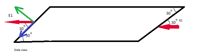

##Q = -6.24*10^{-10} C ##I already figured out the solution, but the only issue I have is the with the angle. I was convinced that I need to use cosine but after I got the answer wrong, I was told that I need to be using the sine function. I thought that since the E fields are moving in the horizontal direction, I would need to use cosine. What is the reason for using sine in this situation? Much appreciated!
