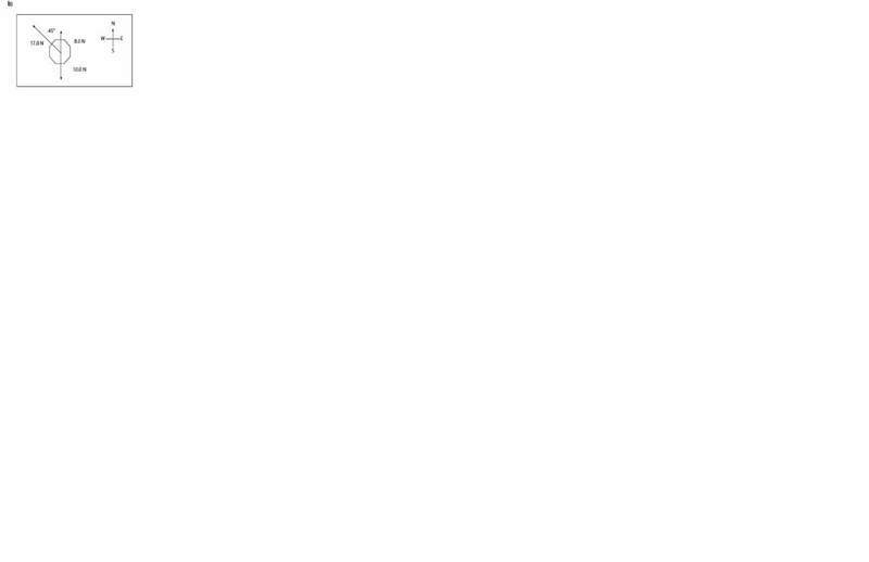

In summary, the homework statement is trying to calculate the net force acting on each object in the following diagrams, but is having trouble with the angle between the resultant vector and the horizontal.
pbonnie
92
Calculate the net force acting on each object indicated in the following diagrams.
c^2 = a^2 + b^2
sinA/a = sinB/b = sinC/c
c^2 = a^2 + b^2 - 2abcosC
Fnet =?
Fnet(v) = 8.0 N [N] + 10.0 N
= 10.0 N - 8.0 N [N]
=2.0 N
I'm not sure what to do after this.
I know the angle opposite the 45° is 180° - 45° = 135°
But I'm not sure how to add the 17 N vector and the 2.0 N vector.
Please help!

Anyway, remember that vectors add "tip to tail" so you slide the 2.0 N southward vector over until its "tail" touches the "tip" of the 17.0 N northwest-ward vector. The resultant then goes from the tail of the 17.0 N to the tip of the 2.0 N. So these three vectors form a triangle, in which you know two of the sides and one angle. This should be enough to apply the cosine law, right?

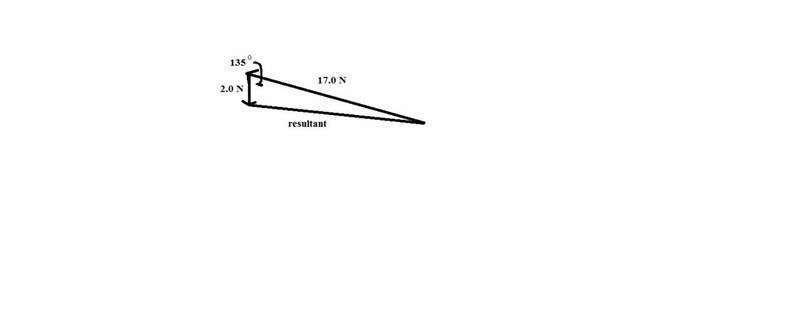

Does the 135° angle sit at the corner of 2.0 N and 17.0 N vector?
So like this? (picture attached, hopefully normal sized!)

Well, yeah, sort of. The angle at that vertex of the triangle is 45 degrees. What you have is 180 minus that, but we want the interior, acute angle, not the exterior one.
Another way to think about it is that the 17.0 N vector is angled 45 degrees from the vertical, and the 2.0 N vector is vertical. Hence the angle between them is...45 degrees.

I agree with your magnitude. Your direction is wrong. Ask yourself: WHICH angle are you measuring when you use the sine law like that? You're measuring the one IN the triangle. But this is the angle between the resultant vector and the 17.0 N vector. What you want is the angle between the resultant vector and the horizontal.
Hint: the 17.0 N vector is 45 deg. from the horizontal. You know the angle between the 17.0 N vector and the resultant. Therefore, you know the angle between the resultant and the horizontal. :wink:
