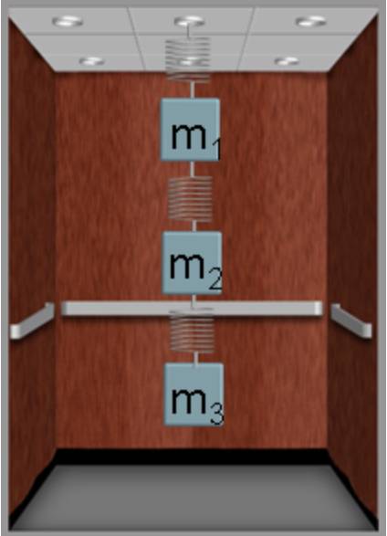

- Homework Statement
- What is the distance the upper spring is streched?
- Relevant Equations
- Fnet = ma
m1 = 4 kg, m2 = 12 kg, m3 = 8 kg. k = 327 N/m for all three blocks. The elevator accelerates upwards at 3.8 m/s^2.
Net force of block one would be equal to force applied by top spring minus weight of system, since top spring is holding all 3 blocks.
F1 = 4*3.8= Fs,top - Wsystem = Fs,top - 24*9.8. Fs,top = 250.4 N = -327x. x = -.76 m displacement
The correct answer is -1 m.
