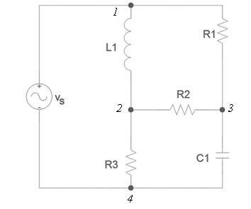

1. Homework Statement
The circuit is driven by a voltage source,
Vs(t)= 8.2 cos(1.8 t − 0.25 )V .
The circuit elements are given as follows.
G1= 5 S,G2= 7.6 S,G3=3.8 S
(Gi is the conductance of corresponding resistor Ri)
L1= 20 H,C1= 5×10−2 F
If we select Node 4 as the reference node, find the node voltage of Node 1, V1.
2. Relevant equations
Σ Ik = 0
ΣVk = 0
3. The attempt at a solution
I've been able to find values for the resistance R1 = 0.2Ω , R2 = 0.132Ω and R3 = 0.263Ω but continuing on from their is a bit of a struggle. I'm unsure as to how I can apply KCL and KVL in a way that will enable me to find the voltage.

Regarding the problem, what component is directly connected between nodes 1 and 4?
The voltage source?
TheBigDig said:
The voltage source?
Yes. What can you conclude from that regarding the potential difference between nodes 1 and 4?
Are you sure that's what the question asks?
