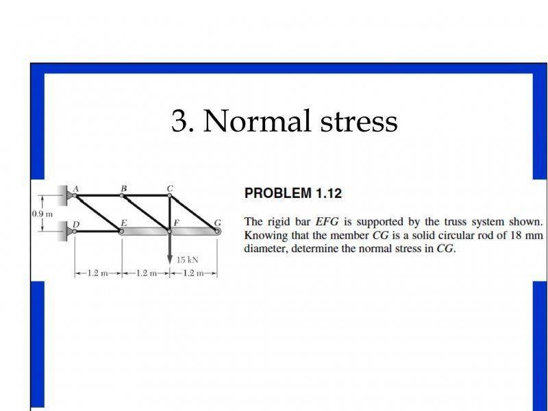

Hello
So I've done some calculations, I'd like to see if my stuff is right. Thanks :)
Please view attached http://i.imgur.com/AfMZyr0.jpg
area = (pi)(9^2) = 254.46
Cos53.13=15/CG
CG=25kN
Normal stress = 25000/254.46
=98.25
You must train yourself to show units with your calculations. You show the normal stress as 98.25 what?
