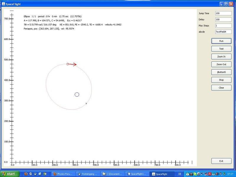

I don't want to take the fun out of it from you so I won't bore you with all the details of my iteration loops etc. Here's a screen shot of what I've got so far.
With my little project I just recently had to solve a a cubic polynomial with the code. That was cool. All kinds of strange things have to get solved. I bet if I continue with it I'll certainly find a Higgs Boson lying somewhere in it by next spring.
