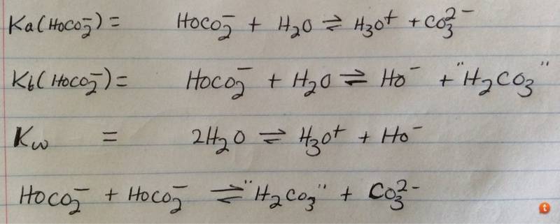

Calculate the pH of a solution containing 5.0 g of [itex]NaHCo_3[/itex] (molar mass = 84.0 g) in 250. mL of H20. [itex]NaHCO_3[/itex] is amphiprotic. [itex]k_a= 4.7x10^{-11}[/itex], [itex]k_b=2.3x10^{-8}[/itex]
This is for a General Chemistry II class, for the record.
I started by calculating the molarity of the NaHCO3 in the solution.
[tex] 5.0g x \frac{1 mole}{84.0 g} x \frac{1}{.250 L}=.238M[/tex]
With that calculated, I wrote out a balanced equation.
Then I set up an ICE (initial, change, equilibrium) chart
[tex] NaHCO_3 + H_2 O→N_aH_2CO_3^++OH^-[/tex]
With an initial molarity of .238 for NaHCO3, and values of 0 for NaCO3+ and OH-, I wrote an equilibrium constant expression for Ka
[tex] \frac{x^2}{.238-x}=4.7x10^{-11}[/tex]
Solving that for x, I get [itex]x=3.35x10^{-6}[/itex]
And taking the -log, I get a pH of 5.47.
The answer is supposed to be a pH of 9.9. What am I missing here? Is this something to do with the amphiprotic nature of NaHCO3? Am I writing an incorrect balanced equation?

[itex]HOCO_{2}^{-} + H_{2}O \leftrightharpoons HO^{-} + H_{2}CO_{3}[/itex]
And yes, you are right, hydrogen carbonate ion is amphiprotic. So the question is now how will it behave in solution? As an acid, or as a base? Or as both?
The answer is both, of course, but the real question is what will the predominant behavior be?
*I say "the" because the reaction I wrote above is hardly the only equilibrium occurring in the system. Bicabonate ion is a wonderfully complex ion and it can react with water:

And bicarb ion can also react with itself! This forms "carbonic acid" and carbonate ion.
It's going to be behaving predominately as an acid since it's donating hydrogen ions, correct? Shouldn't that be [itex]H_2CO_3[/itex] though? The equation you've written has an uneven number of hydrogen ions. I was always taught that a balanced equation was necessary in these problems. Do I need to balance it with an additional 2H+?

You are correct! I wrote that reaction by mistake. I forgot about conjugate theory; the bicarb ion is behaving as a base in that reaction and so it becomes its conjugate acid, carbonic acid. Water in that reaction is the acid and becomes its conjugate base, the hydroxide ion.
Simply because something can donate hydrogen protons does not mean that it necessarily will to a large extent. Consider ammonia. We usually consider ammonia a base in water solution because even though it has three hydrogen protons - which can all be donated (at least in theory) - the formation of the amide ion, [itex]H_{2}N^{-}[/itex], is unfavorable (very much so in water solution). So try thinking about what K expressions stand for and what they mean.

The bicarb ion sure is acting as a base in the equation I wrote above, but still, the following questions remain:
1) How do you know it is predominantly acting as a base?
2) If you have another amphiprotic substance, how do you know whether it is a base or an acid if I didn't write out the main equilibrium?
Got it!
I had been thinking that it was behaving as an acid, so I was setting my equilibrium constant expression equal to Ka. I set it equal to Kb this time to get my OH- concentration, took the -log and got a pOH of 4.13. Then I subtracted that from 14 and got the correct pH of 9.9.

Try writing out the Ka and Kb expressions for hydrogen carbonate ion. Let them talk to you.

Great! Now what if your test had these choices:
a) pH = 9.9
b) pH = 5.5
So, we're about to untangle this. Just let the K expressions start talking to you. Remember that in general:
[tex]K = \frac{[product]}{[reactant]}[/tex]
So think about the implications of that fraction and the value that the fraction is set equal to.
Can I determine that it's acting as a base simply because I end up with OH- as one of the products? If it was acting as an acid, it would have gone to H30+ as one of the products, right?
Is it because HCO3- is a negative species interacting with a neutral species (H2O)?
The problem with this is that there are multiple, simultaneous equilibria in the system. Here are 4. As we can see, we end up with both hydroxide ion and hydronium ion as products. The question now is 1) which one matters and 2) to what extent does the one that matters reach? (Assuming there is only equilibrium that matters, but as far as I can tell, your general chemistry class has not gone very much into depth with consideration of acid/base systems).

Negatively charged species can also be fairly strong acids - consider [itex]HOSO_{3}^{-}[/itex], which has a Ka of 1.2 * 10-2. Not a strong acid in water per se but definitely up there on the totem pole for weak acids.
So again, we must go back to our K expression. Write out the equations corresponding to the reactions of hydrogen carbonate ion as an acid and as a base and write out their corresponding K expressions. Set these K expressions equal to the appropriate values. Let this all talk to you. For example, if we have a large K value, what does this say about the ratio of products to reactants? What about small? What are the relative sizes of Ka and Kb for hydrogen carbonate ion? What may you conclude from this?
If the concentration of H+ is greater than the concentration of OH-, it's a acidic...and if the concentration of H+ is less than OH-, it's basic. If the two are equal, then it's neutral?
That's what I'm seeing from looking back in my notes. I don't recall us ever even really going too in depth about how to determine that.
That is right but how do you know the concentration of either a priori? Again, please consider the K expressions in the ways I mentioned above.
