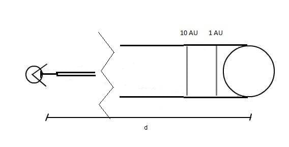

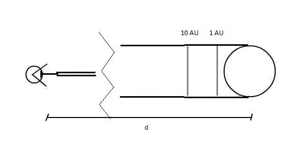

I noticed it doesn't take the distance difference from you to the planet and from you to the star into account.
It doesn't, because the distance to the star is so much greater than the dimensions of the observed system, that the light rays you receive are effectively parallel.

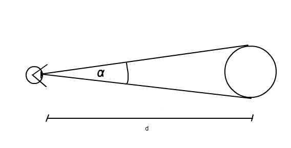

Say, you look at a star:
As the distance ##d## increases, the angle ##\alpha## goes down. At astronomical distances, this means that even for large stars the angle is almost 0, and the light rays coming from the edges of the star are practically parallel in its closest neighbourhood:
So the amount of light blocked by a planet transiting at e.g. either 1 or 10 AU is so close to equal, that any difference gets swamped by instrument inaccuracies anyway.
