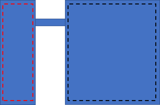

Envision an imaginary balloon that surrounds the air that will eventually fill the high pressure cylinder at the final pressure. During the process, this air expands to push the air that surrounds it ahead of it out of the exit valve. The air in the imaginary balloon is at the same temperature and pressure as the air that surrounds it, and so the air within the imaginary balloon experiences an adiabatic reversible expansion. The initial specific volume of the air within the balloon is ##v_{1.i}=V/m_{1,i}## and its final specific volume is ##v_{1,f}=V/m_{1,f}##.

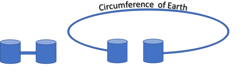

I don't think I've fully considered how the adiabtic expansion works before. The air is going from the high pressure cylinder filling the low pressure cylinder.
What do you mean by:
It seems like the balloons (represented by the dashed boundary) are initially:

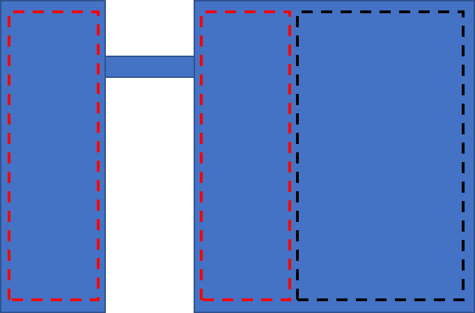

and in the final state they are like:

No. The red ballon initially fills only part of the left chamber. In the final state, it fills the entire left chamber.

The number of moles ( or mass) is assumed to be constant. These tanks are losing/gaining mass?
erobz said:
I read this Adiabatic Process and I see that to get to:
The number of moles inside the balloon is constant.
Ok, "the balloon" contains the final mass in the cylinder. I think I get it now. Thanks!
correct. Let's see what you calculate for the final temperature, the initial number of moles, the final number of moles in the left chamber.
