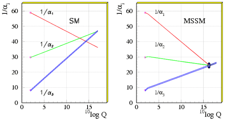

The latter two I have taken from the left plot shown here where I've said [itex]\alpha = g / 4\pi[/itex]:
Anyway, when I compute this, what I find is a number of the order [itex]\Gamma \approx 10^{-64}[/itex]. I assume one then gets the proton lifetime [itex]\tau_{p}[/itex]. by taking [itex]\tau_{p} = 1 / \Gamma[/itex], but clearly I end up very far away from [itex]10^{29} - 10^{31}[/itex] years.

1) is they use [itex]M_{V} \equiv M_{XY} = 10^{16}[/itex] GeV. For a non-SUSY calculation I thought this should be [itex]M_{XY} = 10^{14}[/itex] but whatever, if I use their number my calculation results in a proton lifetime of [itex]\tau_{p} \approx 4.7 \times 10^{36}[/itex] years. Off by a factor of 1000.
2) The only input I choose myself is that of [itex]g_{GUT}[/itex], this is the only variable they do not state a value for. Is it correct to have set [itex]g_{GUT} = \sqrt{ 4\pi\alpha_{GUT} } = \sqrt{ 4\pi(\frac{1}{40}) } \approx 0.561[/itex] ? Actually if they have used [itex]M_{XY} = 10^{16}[/itex] GeV (ie. SUSY GUT scale) then I should use the corresponding [itex]\alpha_{GUT}^{-1} = 25[/itex] as that is the SUSY unification value... If I adjust [itex]g_{GUT} \approx 3.5 [/itex] I can reproduce their [itex]\tau_{p} = 3\times 10^{33}[/itex] years...
