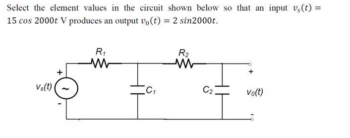

Calculating R and C values given input and output voltage
In summary, the problem was to find the gain and angle of a filter with two identical stages. The solution involves transforming it to polar form and solving for values of R and θ.

To simplify the algebra it was suggested that I set $$ R_{1}=R_{2}=R $$ and $$C_{1}=C_{2}=C $$ So that's what I did. I labeled the voltage in the middle node as $$ V_{1} $$Taking KCL at the middle node gives $$ \frac{V_{s}-V_{1}}{R}-j\omega CV_{1}+\frac{V_{0}-V_{1}}{R} =0 $$ which simplifies to $$V_{1}=\frac{V_{s}+V_{0}}{2+jR\omega C} $$Then I took KCL at the rightmost node, giving $$V_{0}=\frac{V_{1}}{1+jR\omega C} $$ after simplification. Substituting my previous expression for $$ V_{1} $$ into the equation gives $$2+3jR\omega C-R^2\omega^2C^2=\frac{V_{s}+V_{0}}{V_{0}} $$After some more simplification. From here on I'm having trouble getting an answer out. I tried substituting in known values $$ \omega=2000, V_{s}=15, V_{0}=-j2 $$ and got some nonsensical equation with no solutions? I think the solution they (very briefly) explained involved transforming it to the polar form but I'm not seeing how that would simplify things. Any pointers will be greatly appreciated, thanks!

I'm not sure it's possible to solve this problem using the assumption of equal resistance and capacitance values. Essentially there are two filter stages of the same layout (simple low-pass RC stages). They will influence each other via their interface impedances, shifting their gains and phase angles. I suspect that you could design for the net phase angle or the gain, but not both at the same time. It would be a pretty nifty coincidence to find that a gain of 2/15 coincides with a phase shift of ##-\pi/2##.
If I may offer a suggestion? If you choose to make the input impedance of the second stage large compared to the output impedance of the first stage then they will effectively behave independently and then you can design each stage with its own gain and angle. The cascaded stages will then multiply gains and add phase angles.

As gneill says, there is no solution is we set R1=R2=R and C1=C2=C, with a gain of 2/15.
However, using his suggestion to have higher impedance in the second stage, a solution is possible.
There are only two equations possible, one for gain and one for phase angle. We need to find a way to formulate the problem so that only two unknowns are to be solved for.
A reasonable way to do this is to make R2 = k*R1 and C2 = k*C1. Then we can arbitrarily pick a value for either R1 or C1. I picked a value for C1 of .005 uF. Then we need only solve for k and R1.

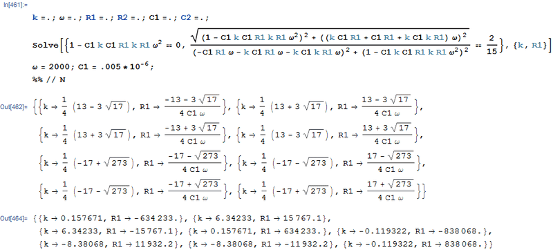

Deriving an expression for the gain, and noting that the phase angle is -90 degrees when (1-R1 C1 R2 C2 ω2) = 0, we can set up two equations, one for phase angle of -90 degrees, and one for a gain of 2/15.
Using Mathematica to do the heavy lifting, I get several solutions, not all of which are feasible:
So a solution with C1=.005 uF is k = 6.34233 and R1 = 15767.1
Testing the circuit with these values verifies its correctness.

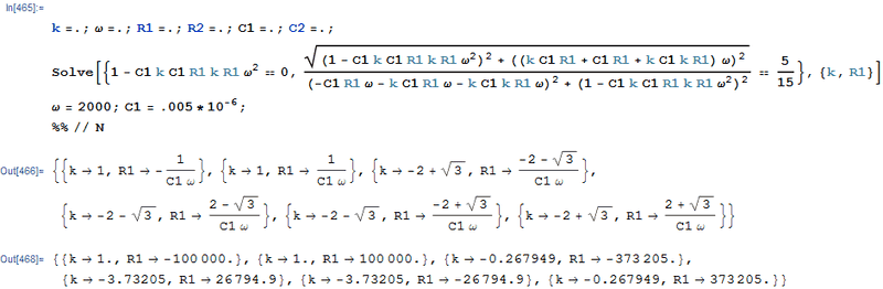

Interestingly, if the gain is set to 5/15, these solutions result. Notice that k is exactly 1 for the feasible solution:
