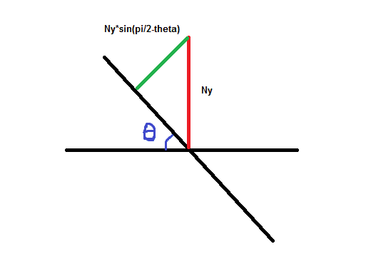

I then tried to do a different type of reasoning and drawed a diagram, which I uploaded. If the diagram is correct, the torque resulting from the N_y reaction force is [tex] N_y L \sin(\pi/2 - \theta) = N_y L \cos(\theta) [/tex] which seems to contradict what I tried before.
I don't follow your method using polar coordinates. But your diagram method looks good. It gives you the correct magnitude of the torque due to Ny. You'll need to consider the sign of this torque when setting up your torque equation.
