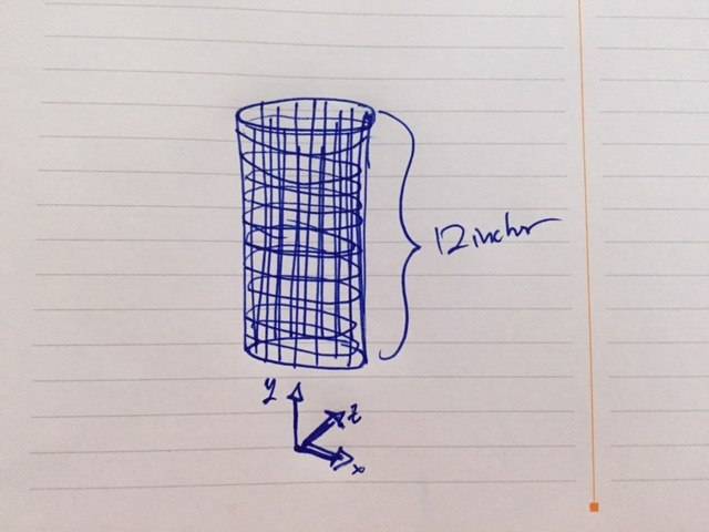

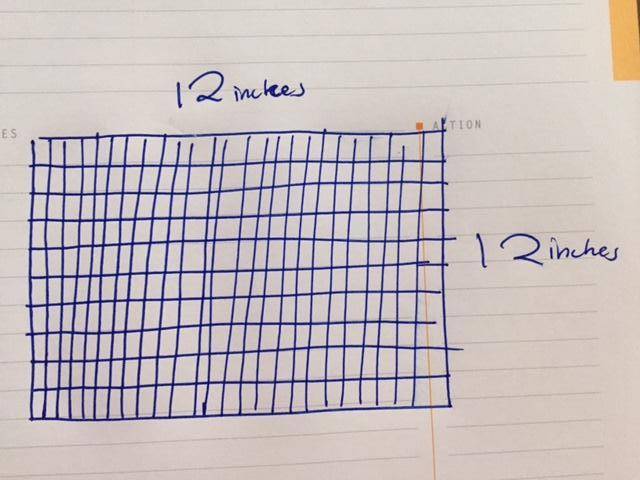

Its a mesh sheet made out of titanium. The goal is to wrap one end and connect it to the other to create a cylinder.
The thickness of the mesh is 0.0020 inches. I
Does that help?

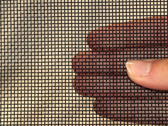

The mesh is made of titanium. Heres what it more or less should look like, albeit finer.
From what I know its a solid sheet that's been perforated to make it a mesh.

If the current will be flowing vertically, then you can ignore the horizontal connections. Just combine all of the parallel vertical resistances.

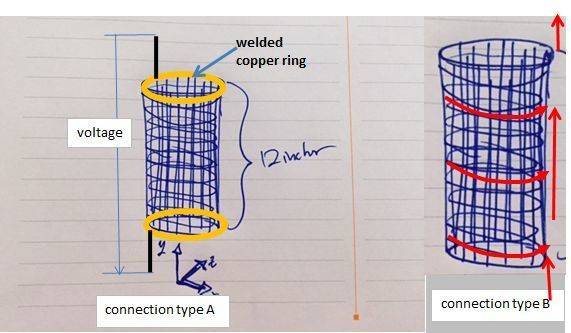

In my opinion, if you'll supply voltage from top to bottom using tight fitted rings[see connection type A], I should agree with berkeman.
Then there are 1200 parallel columns [12/0.01] each one of 12 inches long and 0.002 inches diameter.
Each column resistance =length[m]*rotitanium[ohm.mm^2/m]/area[mm^2]
Rcolumn=12*25.4/1000*0.043/ 0.00202683=6.4665 ohm
Rtotal=Rcolumn/1200=6.4665/1200=0.00538871 ohm
However, if the outgoing wire is connected with a column only[see connection type B] the calculation is more complicated.
Likes berkeman
