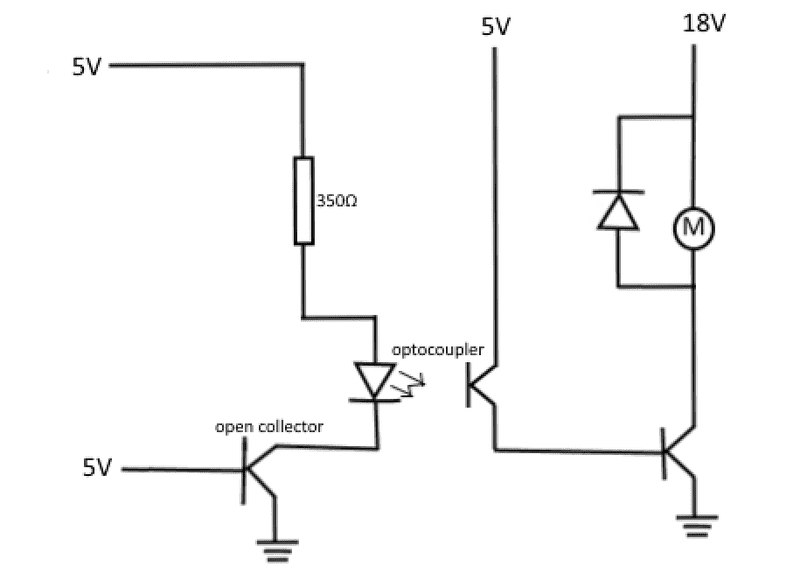

As a project I have to design a switching circuit for a switched reluctance motor. I've picked all the components I need and I've tried to design the circuit.
Open collector - 74LS06N
Optocoupler - TLP 251
IGBT - stgp6nc60hd
Does the circuit look okay and will it work or are there any additions to be made?
Also, is the current limiting resistor I calculated correct for that optocoupler?
Please don't suggest any improvements, I just want to know if that design will work.

Looks close. Which optocoupler? What does the datasheet recommend for the LED current? What is the CTR (current transfer ratio) of the opto, and what is the gm of the output transistor? What is the gain of the final motor drive transistor, and is it sized right for the motor current?
I'm kinda new to all this and I don't have a clue what you're talking about.
What do you mean which optocoupler? It's a TLP251. Why do I need to find the LED current, CRT and gm?
How do I calculate the values of current limiting resistors I need at the base and collector of transistors. What information do I use off the datasheet of devices and what formulas do I use to calculate the values?
Your question is far too general to be addressed without writing an entire book on the subject! There are many different circuit configurations that use different approaches, and how the circuit is meant to behave has a bearing on it, too.
I suggest that you prepare a specific example (circuit layout, chosen transistor with its data sheet, any necessary operating conditions, etc.) and show an attempt. We can't help you if you don't give us something to work with.

The LED current is set by the LED volteae drop, the 5V and that resiator. The CTR and gains are to check that your circuit has enough current drive for the motor.

It appears to me that your circuit diagram is a "concept level" diagram, rather than a working circuit design. The lack of current limiting resistors for the base circuits of the transistors is an indication of this. The "open collector" designation on the input transistor leads me to think that this might represent a generic open collector output from some IC chip, possibly a microcontroller for example.
The optocoupler in your circuit diagram doesn't look like a TLP 251. Check the data sheet. Is your design "married" to this particular part or are you free to choose another?
To determine the values for any current limiting resistors you'll need to pick out the various minimum, maximum, and typical currents for the selected components. That's where the datasheets come in. With the chosen supply voltages, required load currents, and typical transistor characteristics (such as base-emitter potential drop) you should be able to make a first guess at component values. Stick them into the circuit and do a more rigorous analysis.
If you're still at the very beginning of designing your circuit you should be doing some research. Look for manufacturer's application notes and implementation examples for their component families related to your application. There are lots of optocouplers and optoisolators out there, for example, and you might find an agreeable starting place from one of their app notes.

The gm of the final drive transistor that sinks the motor current? What are you expecting the motor current to be?

3.21A per phase

I only have the TLP251 available. Is it possible to use it in this design?
I don't really know how to calculate values I need for resistors for the base of transistors. I don't know what I'm looking at when I look at the datasheets.
