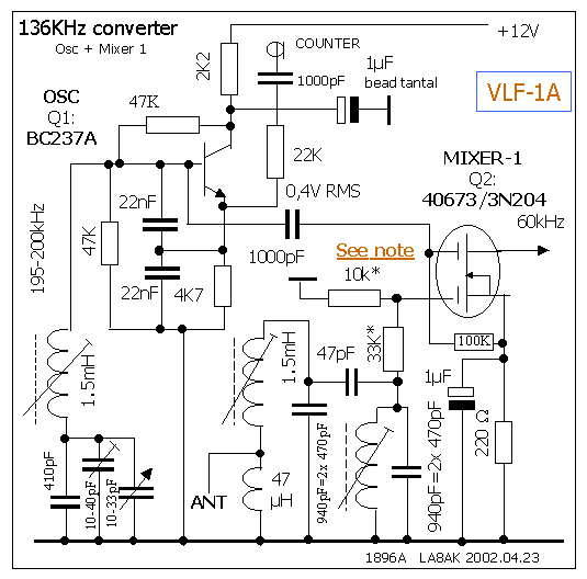

This is not the normal Clapp oscillator circuit. Normally, the coil and capacitors are on the base side of a transistor (or the gate side of a FET) and they are between the base and emitter (or gate and source of a FET).
It is usually like this, if you ignore the component values and everything to the right of the oscillator:
All the capacitors are in series across the coil so they all have to be considered when working out the resonance frequency.
Do not forget that the transistor DC operating voltages must be OK before this or any other circuit will work. So zero volts or 15 volts on the emitter would be unacceptable.
The inductor marked RFC in your diagram could be modeled with 1 mH.
