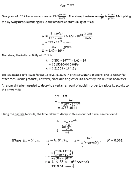

Ok, I've attempted a solution for this. Don't judge ;)
1. This seems way too long, for a GRAM of cesium.
2. The initial activity has no effect on my solution :/
I'm doing this wrong, I presume. What do I need to fix?

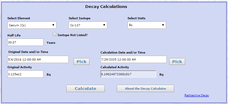

Actually, using this calculator confirms my answer is correct... I hope...
is there anything wrong guys?
This is the time you have to wait until 100% pure radioactive cesium* becomes safe drinking water. Well, if we replace the decay products by water.
*which would evaporate under its own heat in practice

Do you mean the caesium IN contamined drinking water?
The concentration of cesium in drinking water is significantly below 1 gram per gram of drinking water (that would not be water at all, it would be a block of cesium). If you start with 0.1 picogram of cesium per gram of drinking water, you get a completely different result.

Oh. I'm confused now. Where does the per gram of water come into this. I just used the 0.2Bq/gram from the website as a 'safe level'. I didn't think of a Cesium/gram of water
Well, your water is mainly water, but with a small amount of cesium in it. The activity in 1 gram of water (=where the limit applies) depends on the amount of cesium in the water. This amount will go down over time.

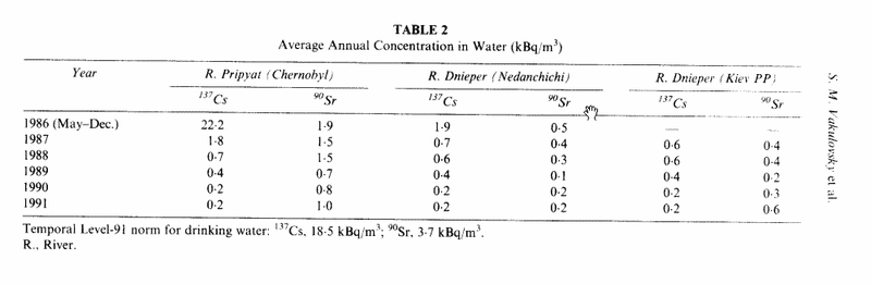

After looking, I found this table:
I am really curious as to why the concentration level (kBq/m^3) goes from 22.2 to 1.8 within a year?
Because it goes down stream.
Likes mfb and Guest432

Ok, so I did the following.
  1. Found how many atoms of Cesium-137 is in a gram of water in 1986 (1.8 kBq)
  2. Found how many atoms in the prescribed safe activity per gram (0.2Bq)
  3. Used the half life formula to calculate the time taken for the initial activity to decay to the second activity.
Note the units: the values are in kBq/m3.
