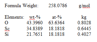

Hello,
I am a museum professional developing a small geological display on the scandium-containing mineral thortveitite.
I will display a glass containing 1850 grams of thortveitite pieces.
In order to make the accompanying text interesting for children, I want to inform them about the potential value of this quantity of thortveitite by calculating the amount of scandium in grams.
Scandium sells for $15.000/kg.
But help oh help, I forgot my chemistry lessons a long time ago.
The formula of thortveitite is: Sc2Si2O7
Is there somebody who can help me?
Thanks in advance!
Ron Werner
Evje og Hornnes geomuseum Fennefoss
Norway
1.850 kg Sc2Si2O7
Likes jim mcnamara and Ron Werner
