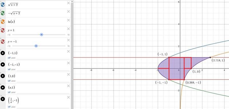

Hello all,
I"m trying to calculate shaded area, that is, the area bounded by the curves ##x=y^{2}-2, x=e^{y}, y=-1##, and ##y=1##:
Integrating w/ respect to ##y## is easy simply because 1) the curves are initially presented to us as functions of ##y##, not ##x##, and 2) we can see that it can be calculated with a single integral:
$$\int\limits_{\scriptsize -1}^{\scriptsize 1}({e^{y}-(y^2-2)}){\;\mathrm{d}y}=\int\limits_{\scriptsize -1}^{\scriptsize 1}({e^{y}-y^2+2}){\;\mathrm{d}y}=\left[e^y-\frac{y^3}{3}+2y\right]{1\atop-1}=\left[e^{(1)}-\frac{(1)^{3}}{3}+2(1)\right]-\left[e^{(-1)}-\frac{(-1)^{3}}{3}+2(-1)\right]$$ $$=\left[e-\frac{1}{3}+2\right]-\left[\frac{1}{e}+\frac{1}{3}-2\right]=e-\frac{1}{3}+2-\frac{1}{e}-\frac{1}{3}+2=\frac{12}{3}-\frac{2}{3}-\frac{1}{e}+e=\frac{10}{3}-\frac{1}{e}+e\approx 5.684$$
...this is the correct answer (as far as I know)...
But of course I couldn't leave well enough alone and decided to do it the hard way (that is, calculate the area by integrating w/ respect to ##x##) as well just for self-edification. Unfortunately I'm not getting the same answer and it's driving me nuts o0). It must be a simple arithmetic or sign error or something, because I'm pretty sure my integration and bounds are correct. Here's how I went about it. First I split up the area into sub-areas according to all the different bounds of integration:
1. First shaded area from ##x=-2## to ##x=-1##:
We see that the vertex of the parabola ##x=y^2-2## is at the point ##(-2,0)##, and that it intercepts the lines ##y=-1## and ##y=1## at the points ##(-1,1)## and ##(-1,-1)##.
Now ##x=y^2-2## is just ##y=\pm \sqrt{x+2}##, so we can just integrate ##y=\sqrt{x+2}## from ##-2## to ##-1## and multiply by two to get the shaded area from ##x=-2## to ##x=-1##:
$$2\int\limits_{\scriptsize -2}^{\scriptsize -1}{\sqrt{x+2}}{\;\mathrm{d}x}=2\int\limits_{\scriptsize -2}^{\scriptsize -1}{\left(x+2\right)^{\frac{1}{2}}}{\;\mathrm{d}x}=2\left[\frac{2}{3}\,\left(x+2\right)^{\frac{3}{2}}\right]{-1\atop-2}=\frac{4}{3}\,\left[\left(\sqrt{x+2}\right)^{3}\right]{-1\atop-2}=\frac{4}{3}\,\left[\left(\sqrt{(-1)+2}\right)^{3}-\left(\sqrt{(-2)+2}\right)^{3}\right]$$ $$=\frac{4}{3}\,\left[1-0\right]=\frac{4}{3}$$
2. The 2nd shaded area is just a rectangle, so no caclulus needed this time (it's just width times height)...but we need to know where ##x=e^y## (which is just ##y=ln(x)##) intercepts ##y=-1##. Some quick math shows us that this point on intersection is ##(1/e, -1)##. Thus the area of this rectangle is its width ##\left| -1-\frac{1}{e}\right|## times its height ##2##, which is just ##\left(1+\frac{1}{e}\right)\cdot 2=2+\frac{2}{e}##.
3. The 3rd shaded area is between the curve ##y=ln(x)## and ##x##-axis from ##x=1/e## to ##x=1## (since that's where the function ##y=ln(x)## intercepts the ##x##-axis):
##\int\limits_{\scriptsize \frac{1}{e}}^{\scriptsize 1}{\ln\left(x\right)}{\;\mathrm{d}x}\rightarrow## let ##u=ln(x)\rightarrow du=\frac{1}{x}dx##; also let ##dx=dv\rightarrow v=x\rightarrow## ##\int\limits_{\scriptsize \frac{1}{e}}^{\scriptsize 1}{u}{\;\mathrm{d}v}=u\,v-\int\limits_{\scriptsize \frac{1}{e}}^{\scriptsize 1}{v}{\;\mathrm{d}u}=x\,\ln\left(x\right)-\int\limits_{\scriptsize \frac{1}{e}}^{\scriptsize 1}{x\cdot \frac{1}{x}}{\;\mathrm{d}x}=x\,\ln\left(x\right)-\int\limits_{\scriptsize \frac{1}{e}}^{\scriptsize 1}{1}{\;\mathrm{d}x}=\left[x\,\ln\left(x\right)-x\right]{1\atop1/e}## ##=(1\,\ln\left(1\right)-1)-(1/e\,\ln\left(1/e\right)-1/e)## ##=(1(0)-1)-(\frac{1}{e}\cdot \left(-1\right)-\frac{1}{e})=(-1)-\left(-\frac{2}{e}\right)=\frac{2}{e}-1\rightarrow## Since this value is negative, we'll take its aboslute value ##\rightarrow## This gives us an area of ##\left | \frac{2}{e}-1 \right |=1-\frac{2}{e}##
4. The 4th shaded area is the small rectangle directly above the area we just calculated inthe previous step. Its area is width times height, which is just ##\left(1-\frac{1}{e}\right)\cdot 1=1-\frac{1}{e}##
5. And finally the 5th shaded area is the area between the curve ##y=ln(x)## and ##y=1##. We see that the lower bound of integration is ##x=1##, and with some quick math, we see that the upper bound is ##x=e##, since that's where the curve ##y=ln(x)## intercepts the line ##y=1##:
$$\int\limits_{\scriptsize 1}^{\scriptsize e}{1-\ln\left(x\right)}{\;\mathrm{d}x}=\int\limits_{\scriptsize 1}^{\scriptsize e}{1}{\;\mathrm{d}x}-\int\limits_{\scriptsize 1}^{\scriptsize e}{\ln\left(x\right)}{\;\mathrm{d}x}=\left[x-(x\,\ln\left(x\right)-x)\right]{e\atop1}=\left[x\,\ln\left(x\right)\right]{e\atop1}=e\,\ln\left(e\right)-1\,\ln\left(1\right)=1-0=1$$
Finally I can sum my calculated areas to get the total area:
$$\frac{4}{3}+2+\frac{2}{e}+1-\frac{2}{e}+1-\frac{1}{e}+1=\frac{19}{3}-\frac{1}{e}\approx 5.965$$
...this is close to [but not equal to] the answer I got when integrating w/ respect to ##y##. I've been over it several times and just can't figure it out. I must be making a small mistake somewhere. Any help would be appreciated.

Do it as three integrals: [tex]\begin{split}
\int_{-2}^{-1} 2\sqrt{x + 2}\,dx + \int_{-1}^{1/e} 2\,dx + \int_{-1/e}^{e} 1 - \ln x\,dx &=
\frac43 + 2(1 + e^{-1}) + \left[ x - (x\ln x - x) \right]_{1/e}^e \\
&= \frac{10}3 + 2e^{-1} + \left[ 2x - x\ln x \right]_{1/e}^e \\
&= \frac{10}3 + 2e^{-1} + (2e - e) - (2e^{-1} + e^{-1}) \\
&= \frac{10}3 + e - e^{-1}\end{split}[/tex]
You certainly have an error in (5), where you find [itex]x - (x \ln x - x) = x\ln x[/itex] rather than the correct [itex]2x - x\ln x[/itex], and a further algebraic error where you state that [itex]e \ln e - 1 \ln 1 = 1 - 0 = 1[/itex]; correct is [itex]e \ln e = e[/itex].

OK, now that I've had a chance to look at your response, it appears I managed to distribute the negative sign to the ##xlnx## but not to the ##x##, and then mistakenly cancelled that ##x## with the ##x## outside the parentheses instead of adding them together. Indeed, when I account for the fact that [itex]x - (x \ln x - x) = 2x - x\ln x[/itex] and not [itex]x\ln x[/itex] (and the fact that the ##elne=e##, not ##1## lol), shaded area 5 ends up being ##e-2##, and the sum of all 5 areas checks out to be ##10/3+e-1/e##.
I knew it would end up being a sign or arithmetic error (or both apparently haha). Thanks for helping me find it
